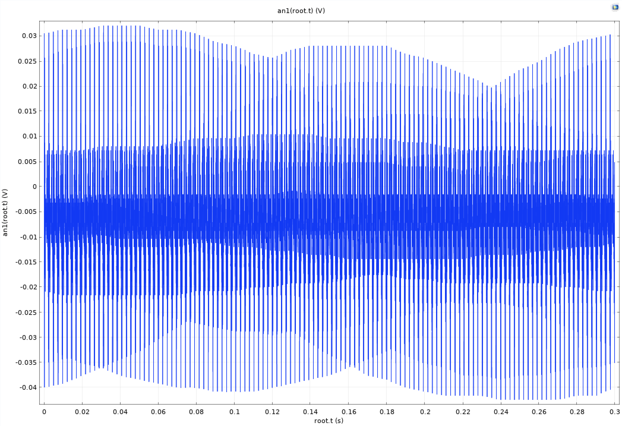

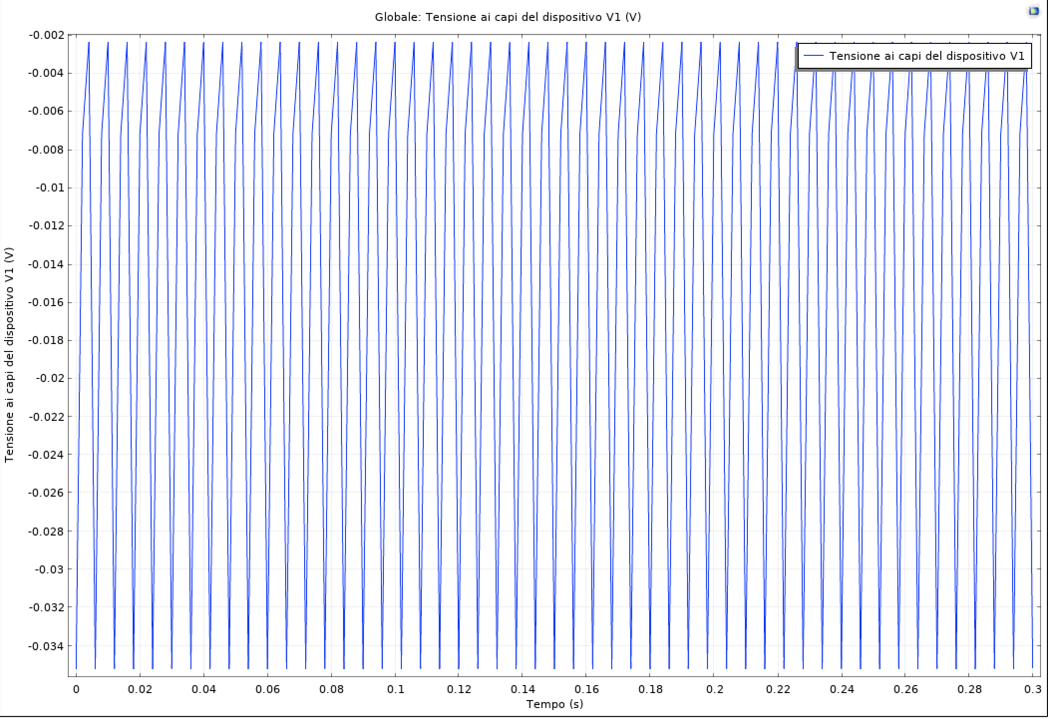

Thanks for the reply, I asked to make sure it couldn't be done. I have another question, with the previous txt file I made the waveform and I made it periodic in the analytic node, after I added it as a local variable. The moment I place it in a DC generator of the circuit I get a completely different waveform in the generator, I have attached the two waves. What are the steps to follow to avoid this problem? I want to realize the second image but I get the first one.

I think I found the problem, the step time used in transient solution was too big, so I was missing many frequency components during the study
