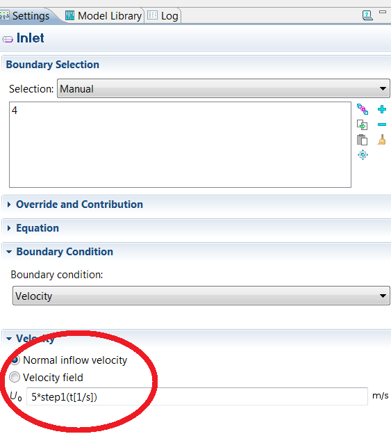

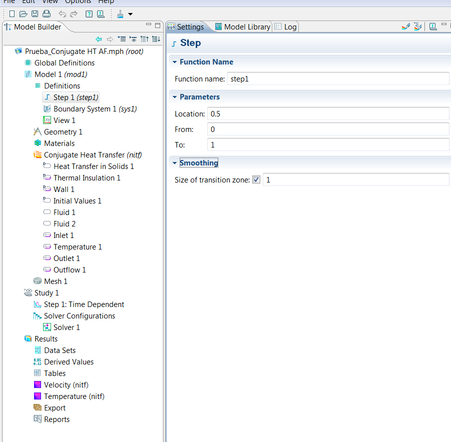

If you go right-click on the Global Definition section a menu will appear, if you move the cursor over function a list of functions will appear, you may use the step function in order to have funtion that varies with time from 0 to 1, you can multiply that function by the value of your inlet velocity and temperature velocity and then solve.
You may want to have a look at the model I posted, you will find the step function and you will see how I changed the boundary conditions for inlet and temperature.
Cheers

I am using the latest version, 4.2a, you may want to upgrade to it. First you need to define the function 'step1' in the Global Definition section (please see the manual) then you need to write in the inlet conditions something like:
v_in*step1(t)
T_in*step1(t)
Cheers

You really need to have a look at the manual to understand the functions section. In the meanwhile you can try to have a look at the screenshots of the file I uploaded before.

Thank you very much for the images!!!!!!!!!!
Of course im still doing,trying to understand this function.Im also looking in this forum about that,but the more similar examples,they have 2 temperatures,i mean,they want to start at 300K and reach 500K after 20 seconds,for example,or something like that.
I just have 1 temperature,i dont know the other one at the final(i want the program to calculate it),so....that is why you are telling me to apply step function also in velocity???
Let us put it this way: have you ever heard of a car able to speed up from 0 to 100 km/hr in zero seconds? No? Well that is because it is not possible, it is not physical.
Exactly in the same way it is not possible to have a fluid going from zero to a finite velocity in zero seconds, therefore you need to describe the inlet velocity going up from zero to the desired value.
Cheers
So,with the step function the temperature and the velocity will vary from zero to the desirable value in a period of time(the value i put in the Smoothing section: Size of the Transition zone) and after that they will change but not affected by this function,loosing temperature due to the heat losses.¿?
