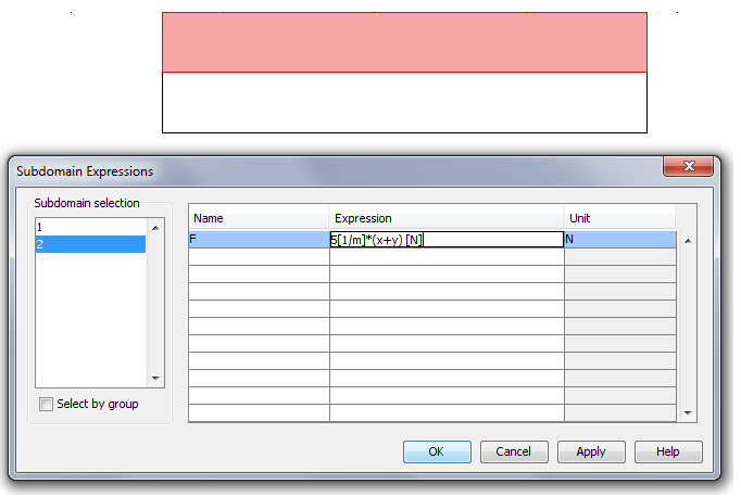

Only one thing is that I'm trying to vary the value of the Volume force based on the point in the bulk of the fluid i.e. to define the force in terms of x and y..
So I went to options, expressions and put F....Comsol couldn't identify F, and there was no option to define F as a force, since the description place could not be changed.
Then I tried defining the for as say F=5(x+y) Newton....and it kept giving an error!
I tried the same in Options--> Functions, and again with no luck.
Please tell me what could be wrong!

I can see no error in the expression..have a look at the attached pic file...
cheers
I can see no error in the expression..have a look at the attached pic file... cheers

Thanks! It worked...just 2 quick questions:

Thanks! It worked...just 2 quick questions: 1. in the in-compressible navier stokes module, in the subdomain settings, there is also a section for porous flow, where u can introduce brinkmann number etc....what does that do? Does it make my given fluid into a porous medium with those assigned properties? 2. If I want to introduce a time-varying volume force, and I don't use moving mesh, is there any way to see the output at a particular time, say at t=5sec? Thanks a lot for your help, and sorry for the bother :-)

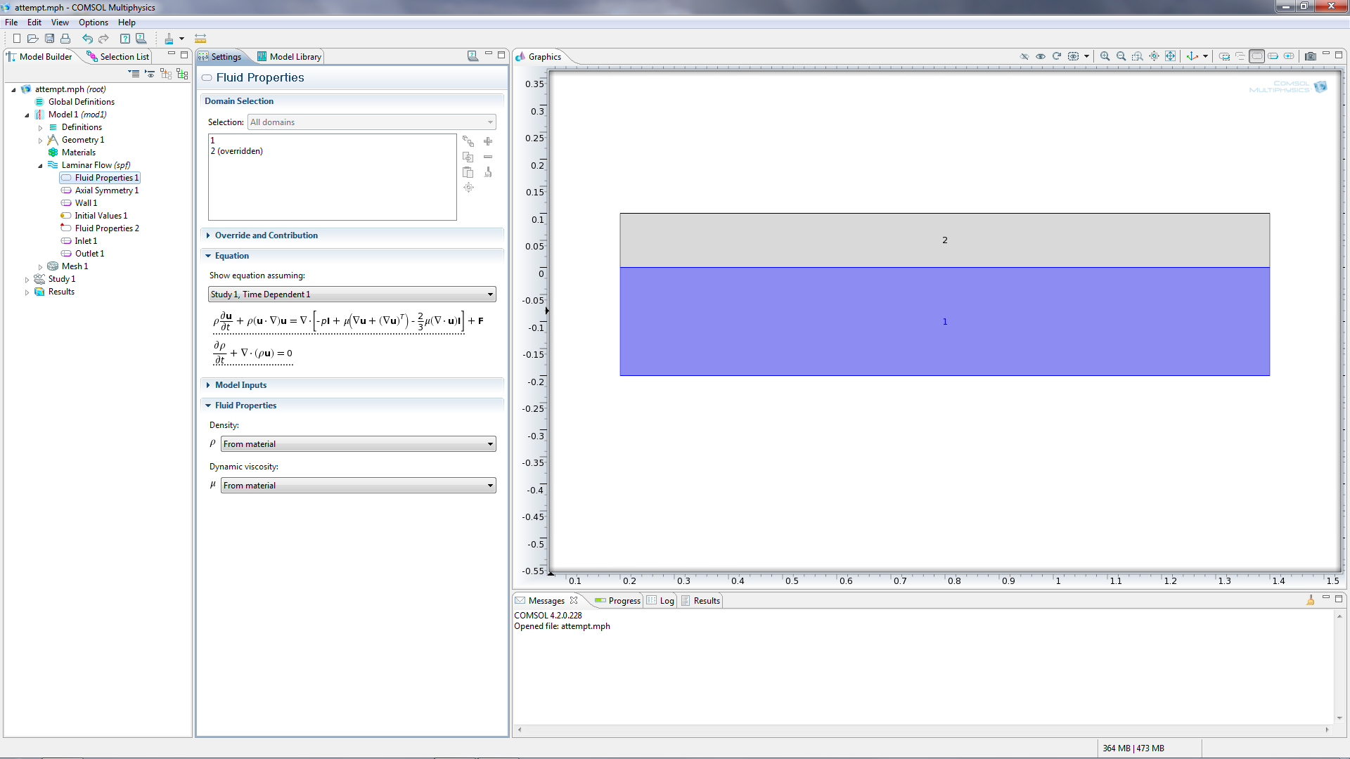

Due to certain problems, I've had to shift to COMSOL 4.0 version...in this, a unique problem that I'm facing is that when I select boundary conditions, whatever I apply to any one boundary gets applied to all of the boundaries...so basically I'm not being able to specify separate boundary conditions for each boundary...please help!

attach your model file..it should not be possible. Are you using Comsol 4.0 or 4.2a? the latest one is 4.2a. I recommend not to use 4.0, it had lot of problems, however i didn't face such boundary condition problem in 4.0.

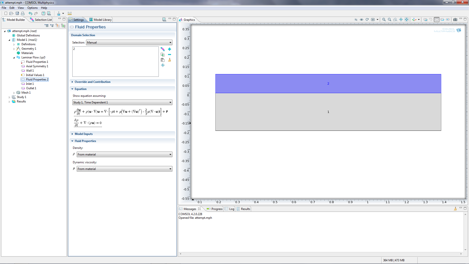

There's a place in the settings window, where it says 'All domains'...so whatever settings I apply to any one domain applies to all of them...all the boundaries etc etc...somehow I just can't change that....there's no option to make it from 'All Domains' to specified domains...
I really haven't done very much..I'm just trying to assign different boundary conditions to each of these boundaries..

you need to add extra boundary conditions; by default Comsol starts with one option for each "fluid properties 1", " Wall 1", "Initial values 1", if axial symmetry then "Axial symmetry 1". Now to add inlet, outlet or if you want to define second sub-domain with different fluid properties then right click on "Lamina Flow (spf)" and add whatever you want. e.g. after adding extra "Fluid properties 2" you can go the geometry window, select and right click whichever domain you want to add under Fluid properties 2; similar procedure apply for boundary selection.

I've now learned how to add stuff....now when I specify each boundary-type, it gets added as wall2 or open boundary 1 etc ...but the default boundary condition as you mentioned in your last post still remains....will that affect my solution, or should I try deleting it, since I really don't want it...?
I'm not sure what's happening, but I'm getting an error:
Failed to evaluate variable Jacobian.
- Variable: mat.rho
- Geometry: 1
- Domain: 1
I've attached the file..its a simple case with only one region...I'm just doing a simple case in which I apply a bulk force and all my boundaries except for the bottom one(wall) are open boundaries...
