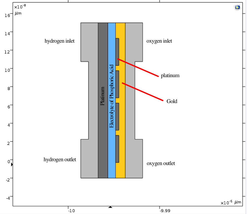

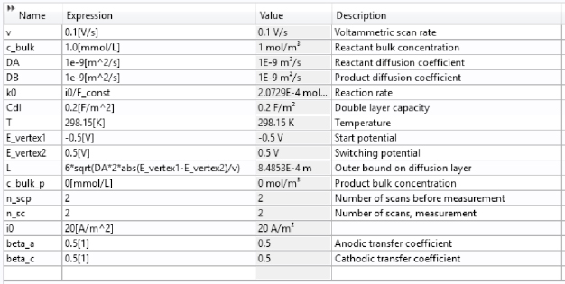

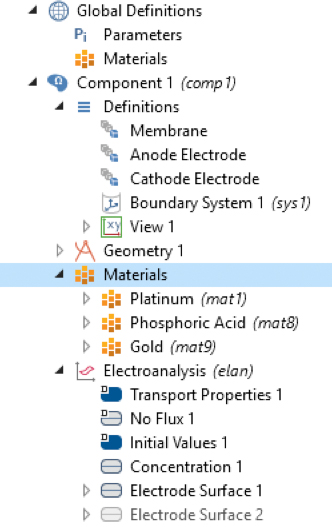

I'm trying to make a 2D model of a Phosphoric Acid Fuel Cell. For the physics part I'm using electroanalysis by adding cyclic voltammetry for the study. I've used the same parameters as the one in COMSOL application gallery (see attachment). I would like to know if i'm defining the components correctly in the electroanalysis or not? (Check the PDF file please). And i would like to know if there's anything i need to add or fix?
