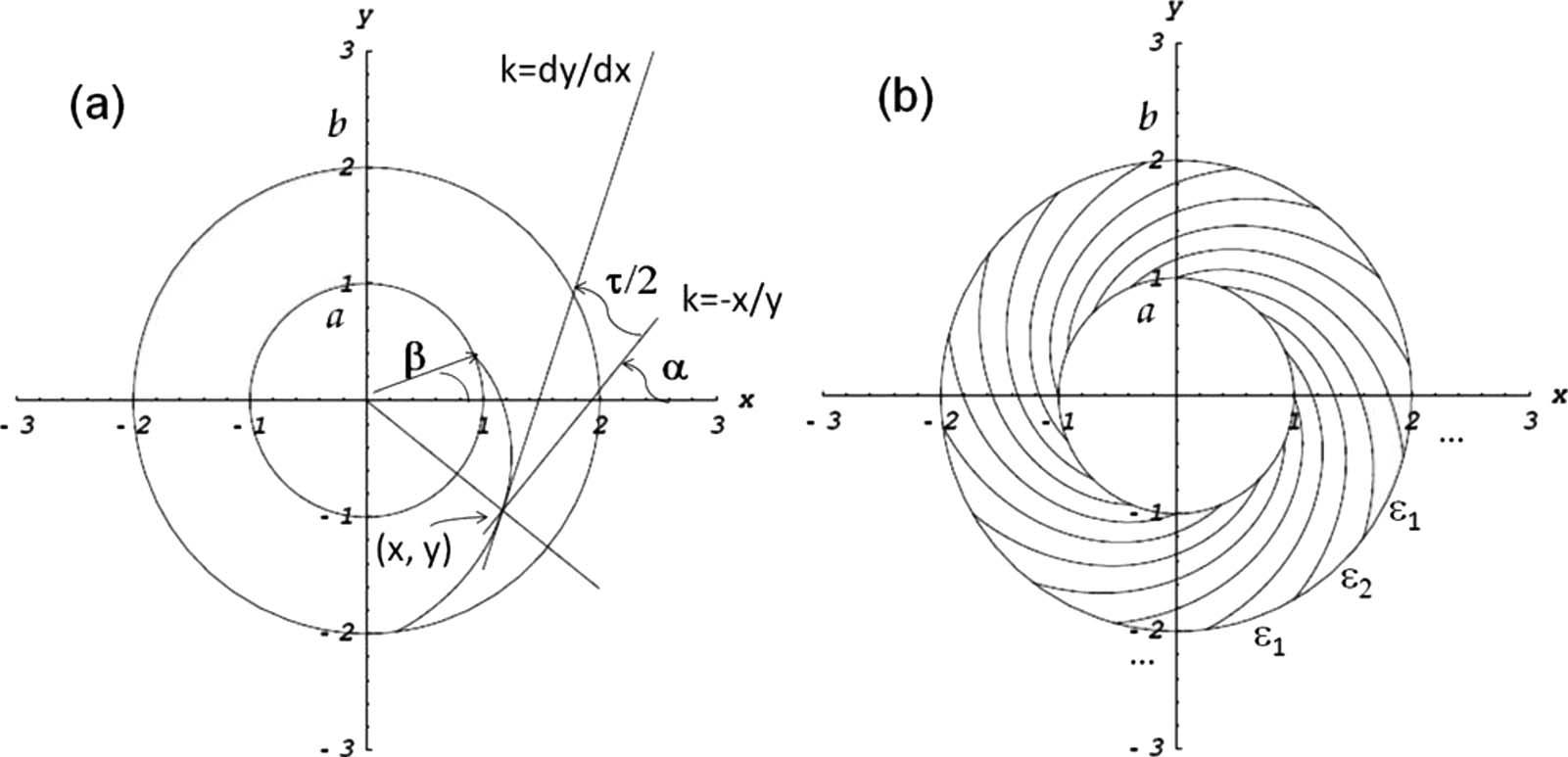

Drawing rotator with parametric curves
Posted 7 ott 2011, 11:43 GMT-4 1 Reply
r = a * exp( theta/cot(tau/2)) ; where tau = 0.5* (sqrt(t^2+4) -t); and t = rotation angle / log(r2/r1)
where r1 and r2 are inner and outer radii.
with parametric curves I just get straight lines.
Advice and help in drawing the curves ( to construct the layered material is appreciated).
Ref : H Chen and CT Chan,Electromagnetic wave manipulator by layered systems using transformation media concept, PRB 78,054204(2008)
thanks in advance.
