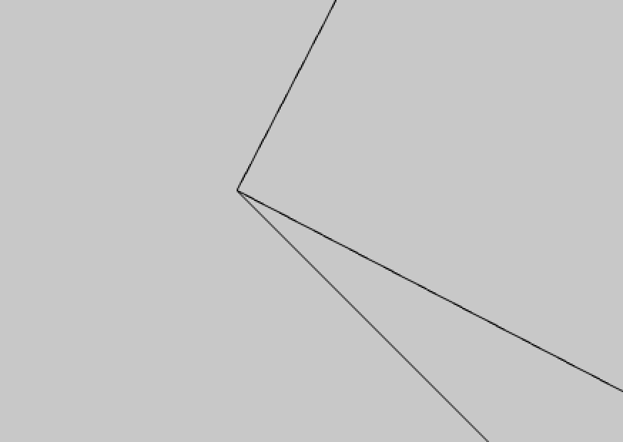

Fillet for three line vertex
Is there anyway to create a fillet for a corner that connects three lines in COMSOL Multiphysics 5.3a for a 2D model?
1 Reply Last Post 1 dic 2018, 08:49 GMT-5
Posted: 7 years ago 1 dic 2018, 08:49 GMT-5
take a look at the attached example. Build the geometry sequence step by step to see the idea. I am not sure if this is what you want. There may be other ways to achieve that.
Cheers Edgar
