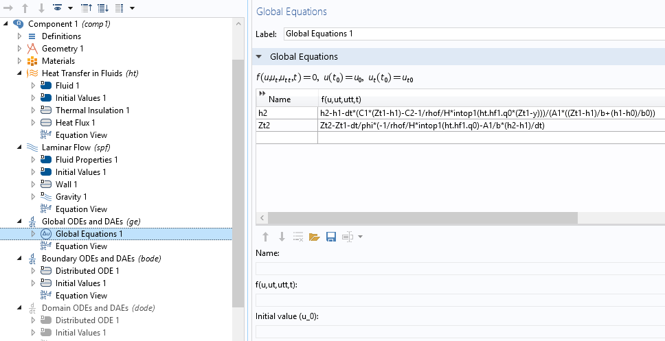

If I understand correctly, you are trying to solve three scalar algebraic equations, each of which includes one or more integrals. So first, you create the integration operators as we've talked about, then you set up the algebraic equations using "Global ODEs and DAEs", which you will find in the Model Wizard under Mathematics > ODE and DAE Interfaces. You can then use the variables from those equations elsewhere else in your model by calling them by name.
Jeff Hiller
Hi Jing, You are correct about the syntax for the integration operator: it takes its argument between parentheses. If I understand correctly, you are trying to solve three scalar algebraic equations, each of which includes one or more integrals. So first, you create the integration operators as we've talked about, then you set up the algebraic equations using "Global ODEs and DAEs", which you will find in the Model Wizard under Mathematics > ODE and DAE Interfaces. You can then use the variables from those equations elsewhere else in your model by calling them by name. Best, Jeff

Hi, Jeff, Your last reply helped a lot. I used "Global ODE and DAE" and got what I need. Thank you so much for your clear explanations. Now I met a new problem, I need to do an integral along a part of one boundary. You know if I use Component couplings and coupling operators>Integration, I can select the boundary that I'd like to integral. In my model, there's a vertical wall (say y=0 to 1), but now I need to do the integral from y=0 to y=y, which means I need to calculate a value for each point on that wall, and I also need them to update the boundary condition for next time step. Do you think it's possible to do with Comsol? Thanks for your time again.
Jing
Hi, Jeff, Your last reply helped a lot. I used "Global ODE and DAE" and got what I need. Thank you so much for your clear explanations. Now I met a new problem, I need to do an integral along a part of one boundary. You know if I use Component couplings and coupling operators>Integration, I can select the boundary that I'd like to integral. In my model, there's a vertical wall (say y=0 to 1), but now I need to do the integral from y=0 to y=y, which means I need to calculate a value for each point on that wall, and I also need them to update the boundary condition for next time step. Do you think it's possible to do with Comsol? Thanks for your time again. Jing

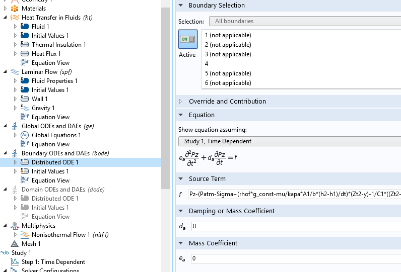

Hi, Jeff, I found out I still couldn't get my boundary condition updated correctly for each time step. Here's my model: (not as complecate as it may look like)
At each time step, Comsol solve the nitf1 (laminar flow, heat transfer model). I define heat flux as my boundary condition. I use Global ODEs and DAEs to calculate one value h2, it's related to h1 and intop1(heat flux), and also value Z2, related to Z1, h2,h1 and intop1(heat flux) all good so far. I also need to calculate Pz, related to h2,h1,Z2,Z1, intop1(heat flux), and y coordinate, Pz is used to update my boundary condition for the next time step. I use Boundary ODEs and DAEs to define it.
Here's my problem: 1.How can I use Pz to update my boundary condition for the next time step, but not affect the boundary condition for this time step? 2. My 2nd goal is to store h2 and Z2 for every time step, but how can I update h2? I want to make it like h2=........, h1=h2, then use new h1 for next step, but I don't know how to make it work in Comsol.
I've tried hard making my question clear, hope you can understand what I mean. I feel it's possible to make it with Comsol, but I searched many thread in forum still didn't find an answer.
Thank you soooooo much.
Best. Jing
