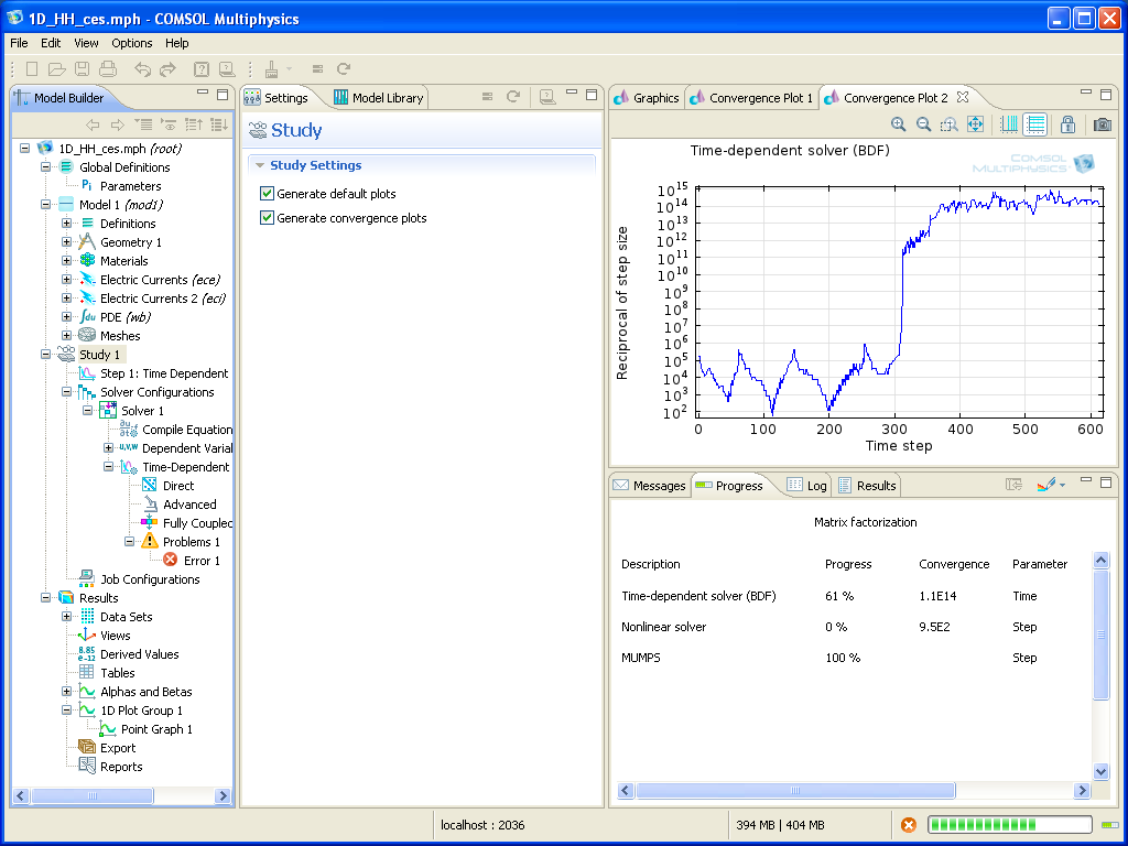

I have the same general symptoms as above: Time-Dependent solution proceeds fine for some time. Then, all of a sudden, the "Reciprocal of step size" on the convergence plot goes to 10^14 and stays there. (See attached convergence plot.)

Note that, as with the others, the simulation runs acceptably for about 100 ms. I am simulating neurons, and the neuron spikes a couple of times, and everything is fine. Suddenly we see this problem. It's not related to any features of the dependent variables or their gradients — it happens away from sharp transitions in any of them, as I can see if I plot "Results While Solving".
My question is: how can I find out which of the dependent variables (I have 4) fails the error test (which is what must be driving the time step to very small)?

Update: I've noticed that, however I set the maximum step size for Strict BDF, the problem always occurs at solver step 300. This could be at 10 ms into the simulation, 50 ms, 100 ms — this depends on the maximum step size setting. So it definitely does not matter what the values of the dependent variables are at the time that it happens — these are different at the different times into the simulation. The simulation runs its normal course. The error always occurs at iteration 300.
• This happens in stand-alone Comsol, as well as running in client+server mode.
• Not a memory issue: Comsol is using under 400 MB, and there are 2+ GB of system memory available if it wanted.
This affects only the BDF solver. Switching to Generalised Alpha avoids the problem behaviour.
