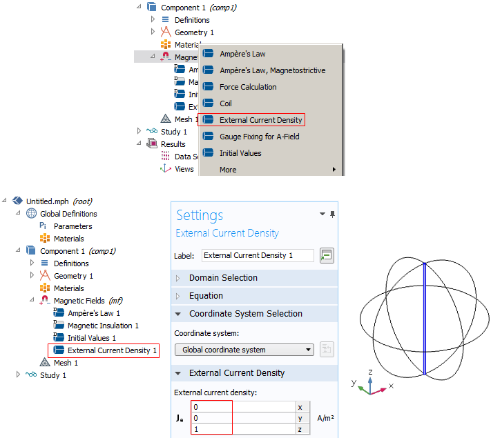

I'm trying to do something I think should be very simple and have been unable to so thus far. I'd like to study the response of a circuit to a magnetic field. This field can be effectively produced by a homogenous time dependent current density flowing through the ambient space that the circuit is in.
So I'd like to just try to get a specific current density to flow through a specified volume of space that I can then put the circuit in. I've tried browsing through the magnetic fields interface, and can't find out how to just specify a current density. I've also looked through user manual it it has been not very helpful. I was hoping someone would have suggestions or a source they can direct me to?

External Current Density on the domain level is available in the (mf) physics interface. Just right-click Magnetic Fields (mf) node and you'll see it, as shown in the attached image.
Sergei
Henry, External Current Density on the domain level is available in the (mf) physics interface. Just right-click Magnetic Fields (mf) node and you'll see it, as shown in the attached image. Regards, Sergei
