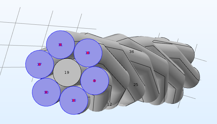

I am trying to model a stranded overhead line conductor of the type ACSR (aluminum conductor-steel reinforced) in 3D Magnetic Fields (mf), Frequency Domain, and I can't get my model to converge. For simplicity I've started out with a single steel core and one layer of helically stranded aluminum layer around the steel core. For the aluminum strands I use the Helix primitive in the Geometry. Form Union and Form Assembly have both been tried out (know the difference between these), and I've tried with and without any physically contact between the single strands.
For the coil domain, I've added coil Inputs to one end of the aluminum strands (see attached image) and Output to the other ends and added the necessary Coil Geometry Analysis under at first position under Study.
I've also tried including an air domain enclosing the simplified conductor (I guess this should be added for the magnetic flux to cause an induction in the steel core), but without any luck.

Joachim,
  1. You don't have air domain enclosing you coil - so no physically maningfull results can be expected with Mahentic Fields physics interface without surrounding air.
  2. After adding air domain, make sure that you have closed loop for the current flow in your coil.
  3. Central steel wire is included in the coil domain but no current excitation is assigned to this wire, which doesnt'n make much physical sence.
Regards, Sergei
Joachim, 1. You don't have air domain enclosing you coil - so no physically maningfull results can be expected with Mahentic Fields physics interface without surrounding air. 2. After adding air domain, make sure that you have closed loop for the current flow in your coil. 3. Central steel wire is included in the coil domain but no current excitation is assigned to this wire, which doesnt'n make much physical sence. Regards, Sergei

  1. I will include again the air cylinder around my stranded conductor.
  2. Should the length of the air domain be exactly the length of the conductor, so that I apply Input and Output at the cross-sections of the conductor right at the Magnetic Insulation (made up of the air cylinder of same length)?
  3. Nicely spotted; I will remove Coil Domain from center steel wire, however, I am sure that this could be a mistake in this attachment only (sorry), and that I have tried without the center wire included in the Coil Domain. Will re-run simulation.

Joachim,
Yes, if you set the length of the air cylinder equal to the length of the conductor, then closing current loop will be formed by the Magnetic Insulation boundary condition which provides the surface current return path, as explaned here:
https://www.comsol.com/blogs/computing-the-inductance-of-a-wire/
In your original model, air conductivity is set to zero. Set it to some small number to get solver convergence.
Sergei
Joachim, Yes, if you set the length of the air cylinder equal to the length of the conductor, then closing current loop will be formed by the Magnetic Insulation boundary condition which provides the surface current return path, as explaned here: https://www.comsol.com/blogs/computing-the-inductance-of-a-wire/ In your original model, air conductivity is set to zero. Set it to some small number to get solver convergence. Regards, Sergei
