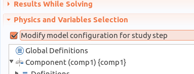

Hi Giulio,
Is the option "Modify model configuration for study step" in the Study Step configuration can do what you want ? Parts of the model can be activated of disabled here ...
Best regards, Etienne

Hi Giulio,
It is. I very apologise for having not noticied it by myself. Btw I'm using the version 6.3 of comsol and I only have the possibility to change the physics and not the geometry. However i suppressed the unwanted automodes fixing the displacement of the notA part to 0 .
