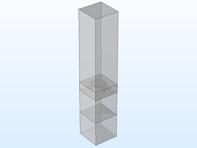

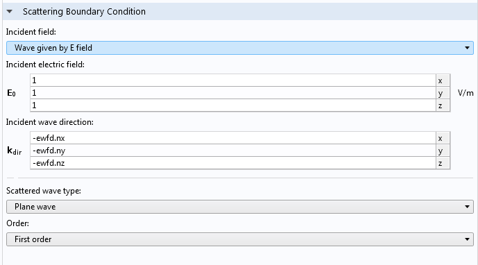

I am trying to obtain a transmission vs wavelength plot using Wave Optics Module and using the model shown in the attached image ("Structure"), which represents a unit cell of a photonic crystal. I send a wave using a scattering boundary condition at the top of the structure (whose parameters can be seen in the attached image "Scattering boundary conditions"). There is a block PML on the bottom of the structure and Floquet periodic boundary conditions all around.
