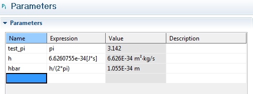

I define some parameters with their associated unit, i.e. Plank's constant. Then, when I use those parameters to calculate other parameters. I found that some time the unit of the derived parameter is incorrect. Most of them have something to do with Plank's constant.
Please see the attached image for an example.

I suspect the problem has to do with the fact that h is already used by COMSOL for the element size.
Try using another name.
I suspect the problem has to do with the fact that h is already used by COMSOL for the element size. Try using another name.
