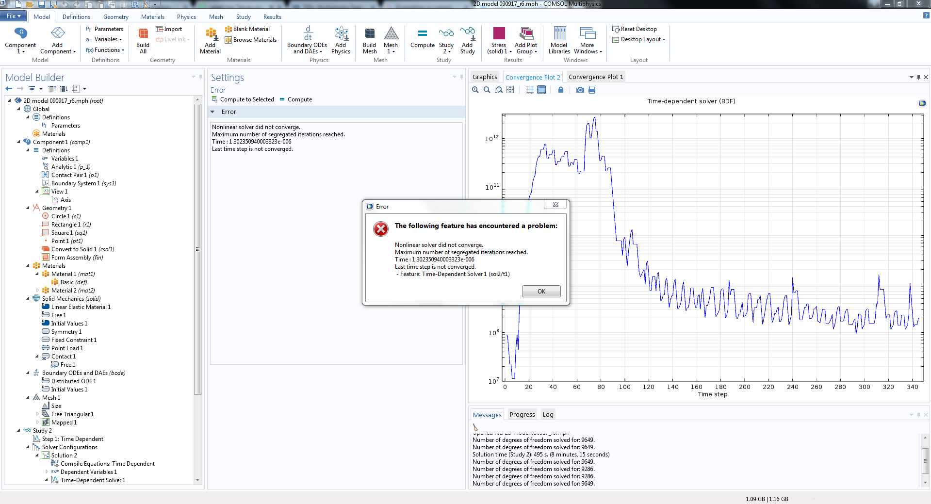

Hello Everyone,
I want to solve the following ODE equation, is comsol capable of solving this?
My wear equation is Wd=Cd*P(t),
where my Cd= kV/H K= wear coefficent, V= sliding velocity and H is hardness of material. My P(t) is contact pressure changing with wear or Time.
So, here my P(t) is changing with wear or time so its a post process result or value changing with time. How can, I give the contact pressure as function of time in ODE?
can anyone please help me on this?
Thanks in advance.
