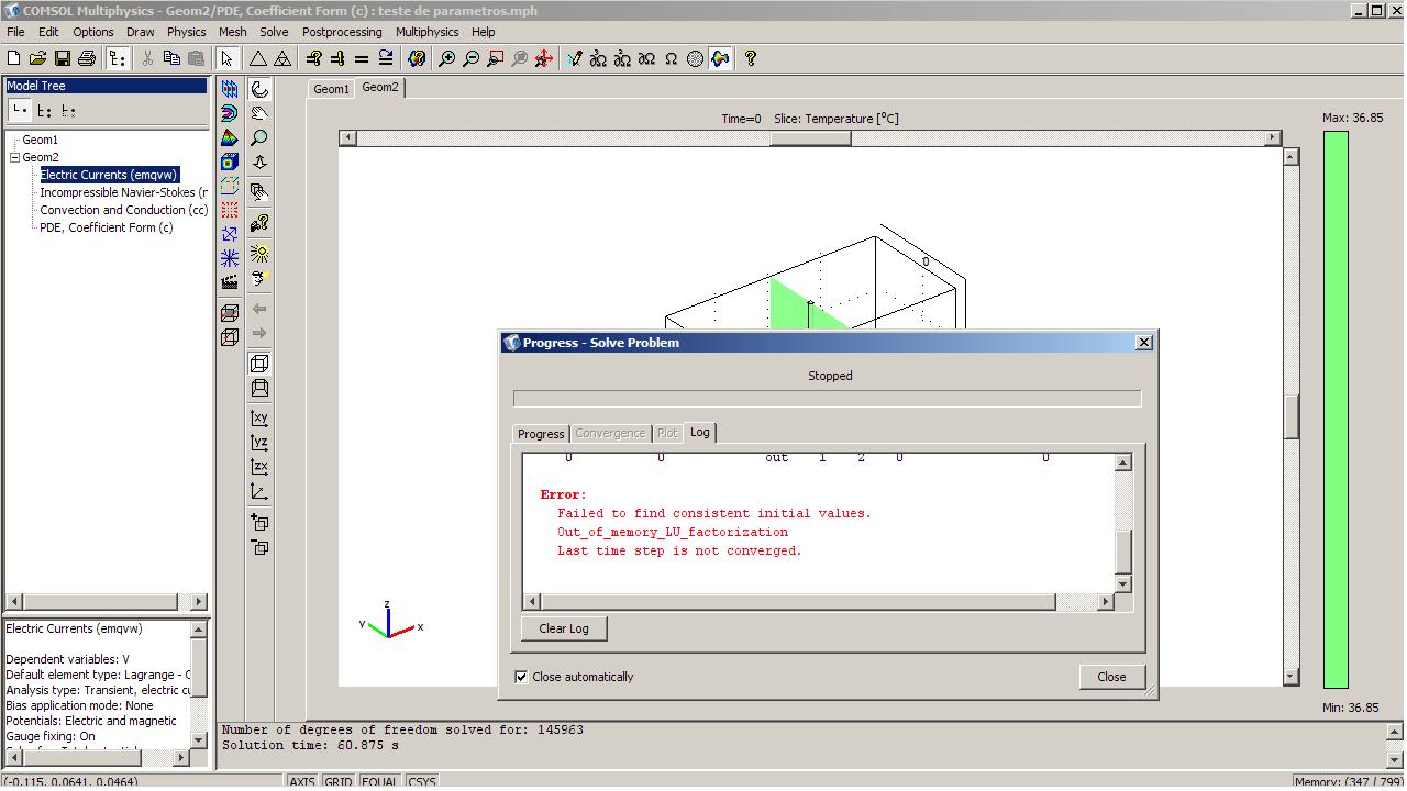

I need help! I am trying to apply an Arrhenius damage integral DURING the solution of an thermal ablation problem using the heat Transfer, electric currents and PDE coefficient form Modules (T, V and u are the dependent variables).
The integral is of the form:
Arrh = integral(A*exp(-E/(R*T))dt)
where Arrh is the Arrenhius damage integral, t is time and A, E, and R are constants. T is the nodal tissue temperature and t is time. I am trying to solve it using the PDE coefficient form Module. However, in the end of the simulation, it appears the following message:
"Error:
Failed to find consistent initial values.
Out_of_memory_LU_factorization
Last time step is not converged."
Any help is WELCOME!
