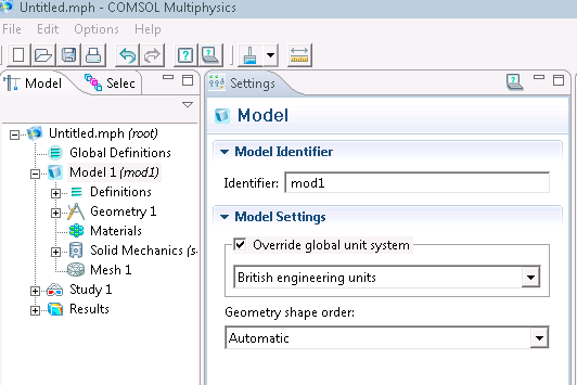

what do you have against the units ? Have you done your homework and read the doc ? You can select the units of your preferrence (see attachedfile, but you should do it before you enter a model as else all conversion of number without units in default unit cells will not follow (how could COMSOL know ?)
Ivar, thanks for your reply.  I have found the settings box from your attached image.  This is the item "Unit System" under "Model"  which seems to allow override of the defaults on a per model basis.
There is also a "Unit System" under the root item (mph filename) which apparently sets the default units for the whole file.
Thank you for pointing this out, I completely missed the settings.  Searching in the Documentation, there is certainly mention of the ability to change units, but it never actually indicates where (in the program) the settings are made.
[/QUOTE]
