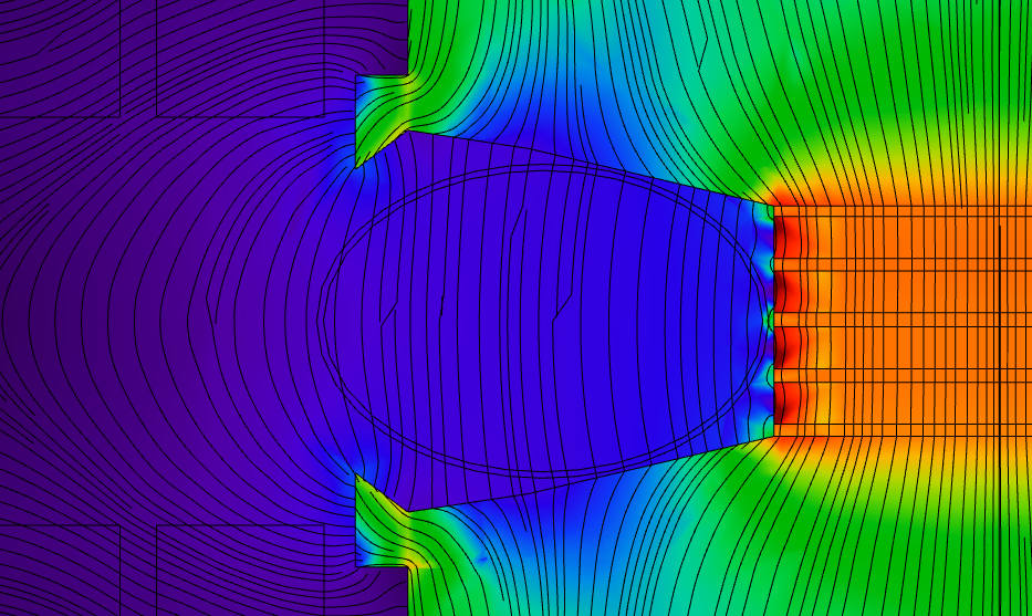

I have solved MF study and now I have to calculate scalar magnetic potential, but I am not to have a clue how to do it. I have values of vector potential (Ax, Ay, Az) and magnetic flux density (Bx, By, Bz) (attachment 1), but it does not give a complete picture of the characteristics of the field.

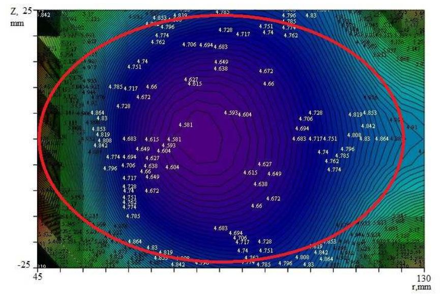

I would like to get a result like attachment 2. I tried a lot of ways but neither of these gives exactly what is wanted.
