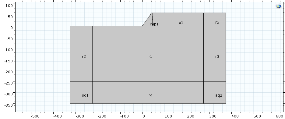

Here is the model:
There is Structural mechanics in imp1, r1,r2,r3,r4,sq1,sq2 and acoustics in b1 and r5.
The solid mechanics PML is in r2,r3,r4,sq1,sq2 while the acoustic PML is in r5.
Alternatively the NRBC is imposed on the external sides of r1 while disabling r2,r3,r4,sq1 and sq2.
The acceleration boundary condition is imposed in imp1 and r1,r2,r3,r4,sq1 and sq2 as a body force or on the sides and bottom of r1 as a boundary condition.
A zero pressure is imposed at the top of b1 and r5.
The study is in the frequency domain.
Here is the model: There is Structural mechanics in imp1, r1,r2,r3,r4,sq1,sq2 and acoustics in b1 and r5. The solid mechanics PML is in r2,r3,r4,sq1,sq2 while the acoustic PML is in r5. Alternatively the NRBC is imposed on the external sides of r1 while disabling r2,r3,r4,sq1 and sq2. The acceleration boundary condition is imposed in imp1 and r1,r2,r3,r4,sq1 and sq2 as a body force or on the sides and bottom of r1 as a boundary condition. A zero pressure is imposed at the top of b1 and r5. The study is in the frequency domain.
