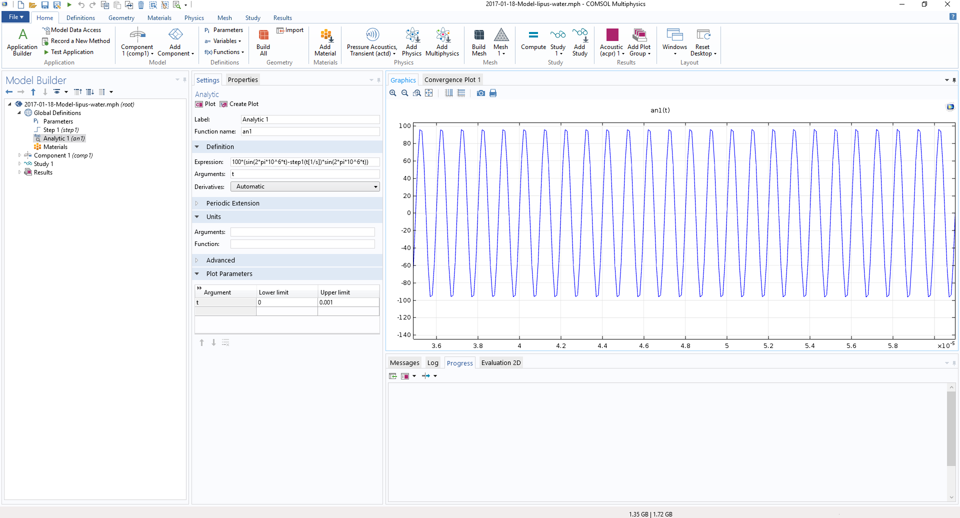

I have made a sine pulse with an analytic function.
My step function goes from 0 to 1at the location of 2e-4. My analytic function is "100*(sin(2*pi*10^6*t)-step1(t[1/s])*sin(2*pi*10^6*t))" and the lower and upper limits are 0 to 0.001.
The problem is when I zoom in the graph does not look like sine wave. Please see the attached image.
If I plot the same function with the frequency of 10KHz instead of 1MHz, it looks fine.
It seems that there is a problem with the graph resolution. Does anyone have any idea how to solve this?
Thanks,
Hamed

Preview plots of functions by default contain 10000 points in 1D. If you want to plot for a higher resolution, click on "Create Plot" in the Settings window's toolbar and increase the resolution in the data set that is created.
If your model contains rapidly varying functions you also have to make sure that the solver settings resolve the dynamics of the functions.
Preview plots of functions by default contain 10000 points in 1D. If you want to plot for a higher resolution, click on "Create Plot" in the Settings window's toolbar and increase the resolution in the data set that is created. If your model contains rapidly varying functions you also have to make sure that the solver settings resolve the dynamics of the functions.

The resolution is defined in the Grid data set used by the plot. Select the Line Graph in the 1D plot group that was created. Click on the Go to Source button in the Data section. This takes you to the data set. Expand the Resolution section and change the resolution.
8 time steps isn't enough to resolve a sine wave, try with more time steps until you're satisfied. That said, if you know that it's a sine wave with some frequency, why do you need to plot it?
