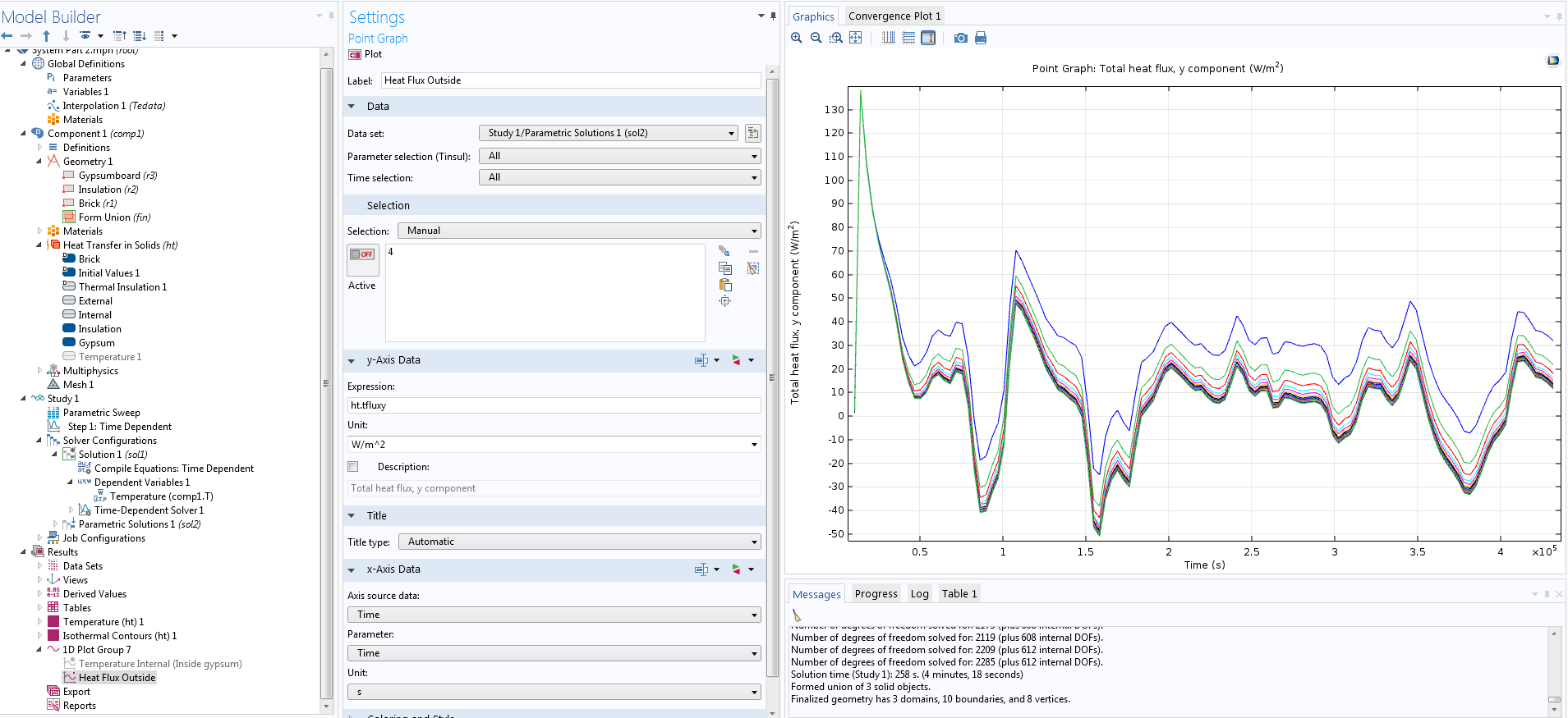

                                                    Thank you very much Ivar
I managed to do it.
However, i end up with a follow up question.
Added, i computed the outgoing heat flux during the year for different Tinsul (insulation thickness).
Now i would like to calculate the surface under the graph (so the total heat flux in the year) and set the up against the Tinsul. So on the y-axis the total heat flux in the year and x-axis the Tinsul. For the total heat flux only the positive numbers some be taken into account (i need to neglect the inward heat flux what occurs when the outside temperature is higher then the inside temperature). How can i set this up easliy?

in COMSOL you have many "operators", also time-integration ones (see the help or the doc), you can also make a Derived Variable and dump the results into a table and then apply operations there too.
In your case, if you want only the positive heat flux part you need to use an explicit time integration and multiply your variable (integrated over the correct boundary) by the Boolean expression timeintegration_of( your_var*(your_var>0) )
another way is to define a global variable (see and search the BLOG for time integration) to directly integrate your heat flux (the positive part of)
