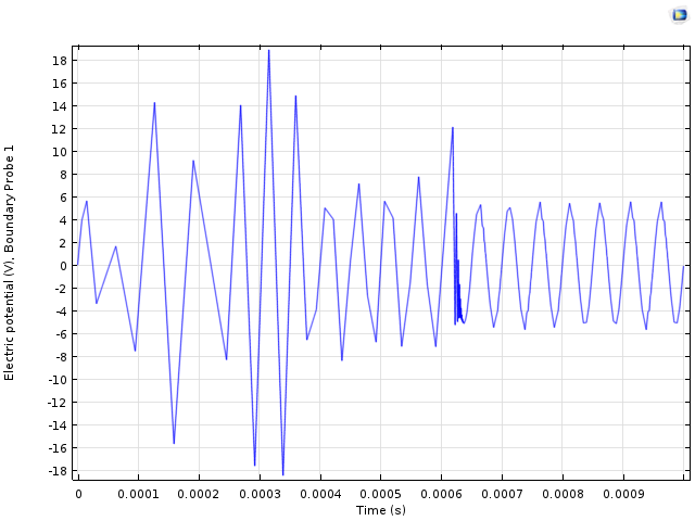

First, I obtained strange results with time steps that were growing between each step (they were not constant). I probed the voltage on the disc, and it did not respect the frequency f0 (it was almost noise) and amplitude V0 (up to 3 times V0).
I then modified the Time Dependent solver, using for the probes "Times stored in output". Now the time steps are good, but the result is still anything. Voltage still goes up to 3 times V0, and frequency is not respected. In fact it is almost respected after some time, call it t0 (like half of the time steps). But if I try to begin at t0, I obtain the same result than before, just starting at t0.

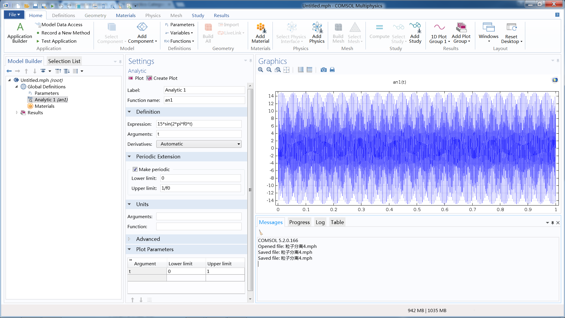

I 'm working on a project including piezoelectric transducer simulation.I have tried the way you suggested when applying a sine excitation with the frequency of 4.6MHz and the duration of 1 second. But what I got when I clicked the 'Plot' button was totally unexpected.
So how can I get a correct sine wave with the frequency of 4.6MHz in COMSOL?

I tried what you did, this is the first time I use the Analytic function (usually I use Waveform).
I think the problem comes from the used sampling frequency. If you try with different frequencies, it works at 1Hz, 10Hz. At 100Hz it starts to do anything, and at 1kHz it goes back to 1Hz.
Unfortunately, I do not know how to impose the sampling frequency. What you can do is setting the Upper limit of Argument t (in Plot Parameters) to a value small enough so that the result is correct.
Or you may use "Waveform" instead of "Analytic" when selecting the kind of Function (which is what I describe in my previous message).
Hope it helps.

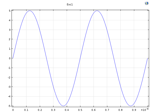

The first problem I would like to resolve is related to the voltage applied to the piezo. I apply a sine voltage (see "Function_V" attached), and when probing the voltage during the simulation, what I obtain is different (see "Probe_V" attached). Note that in the probe file, there are many points, even if it looks like there is only a few (when they draw straight lines, they are drawn with many points). If I compute it over a longer time, it is even worth (see "Probe_V2"). Here, figure have been obtained with a "spring foundation", but it stays the same with a roller or nothing. I just wonder if solving this problem could solve all the others.

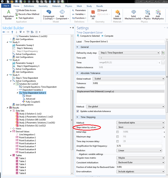

I think maybe you have to reduce your time-step increments because it seems they are too big and that creates the jumps in your Probe_V results you showed.
If that is the case you can in addition change the time stepping in the solver to "strict" or "intermediate"

Thank you for your help, now Comsol applies the good voltage !
But I am afraid that it does not resolve all my problems, as the deformation of the piezo is not perfectly related to the voltage (see attached, using a probe to determine the displacement of a part of the disc). I will try to find if this is normal or not, and add something here (or ask some more questions).
