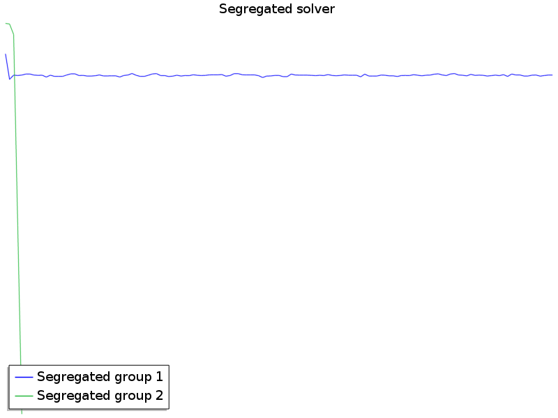

I posted the error plot in the attachment. Does anyone give any advice about it?
