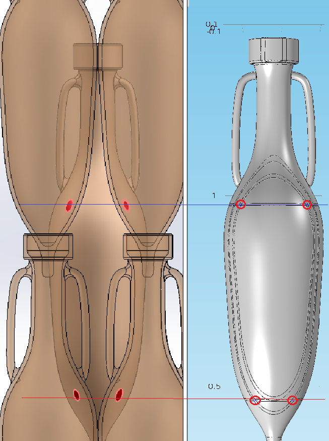

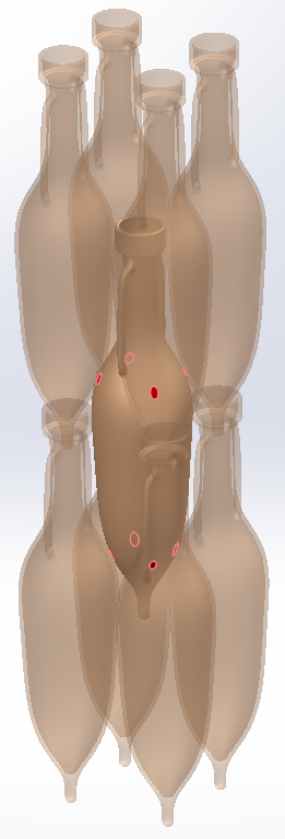

We, students from TU Delft are currently busy with a materials engineering project on structure of ancient ceramics.
I would like to model an Amphora (imported from solidworks) positioned in between four other amphora.(see picture afbeelding stapeling contact punten 2.png) Because the amphora have point contacts, I need to model a Force on a curved surface, no edges nor plane surfaces. therefore I have made partitions so I can set a boundary on these small created domains (see picture comsol contact punten.png). I did this via Geometry -> Work plane -> Partition objects. After that I placed an equally distributed load on those small surfaces.

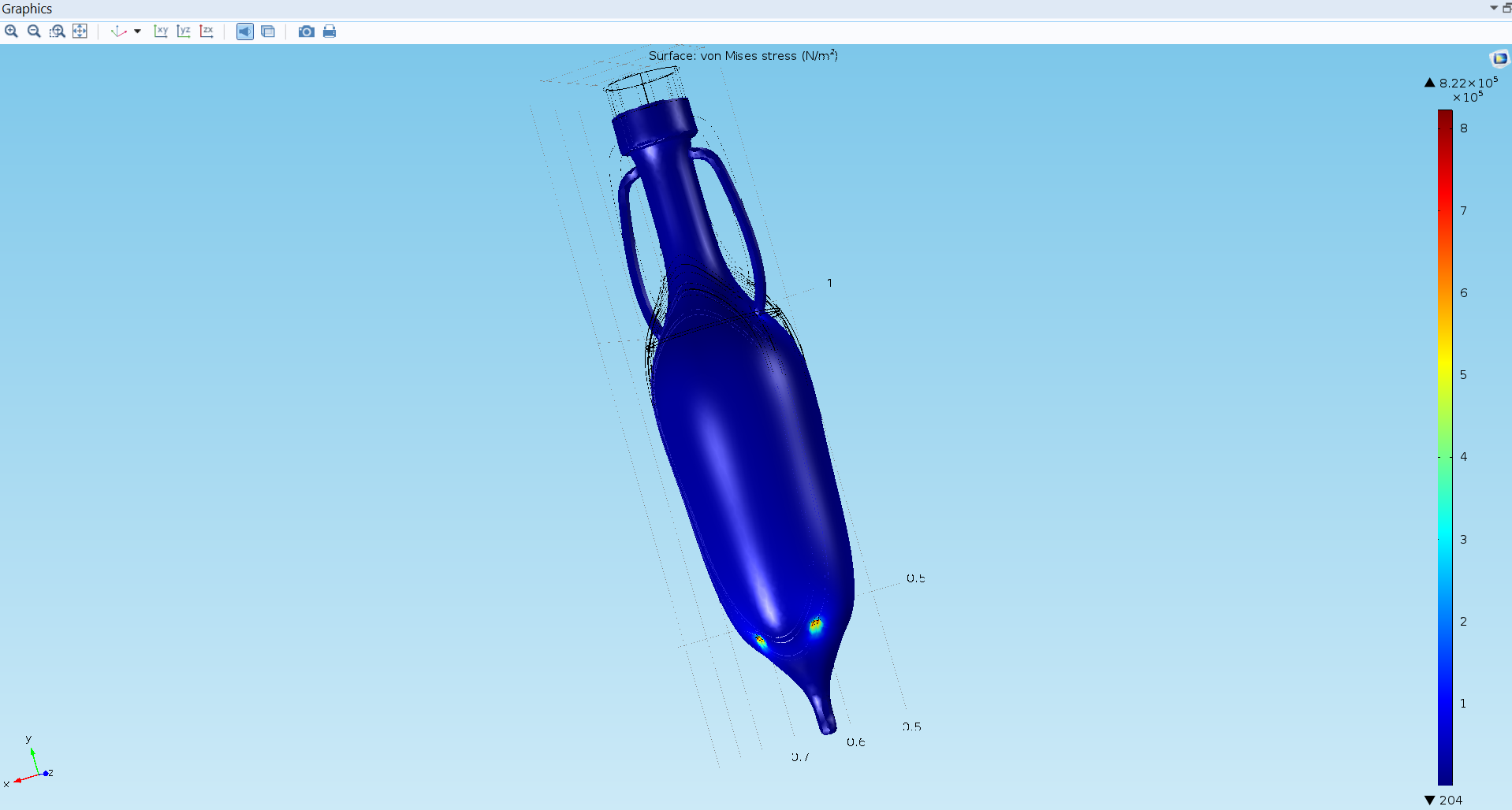

(results see picture stress.png )
