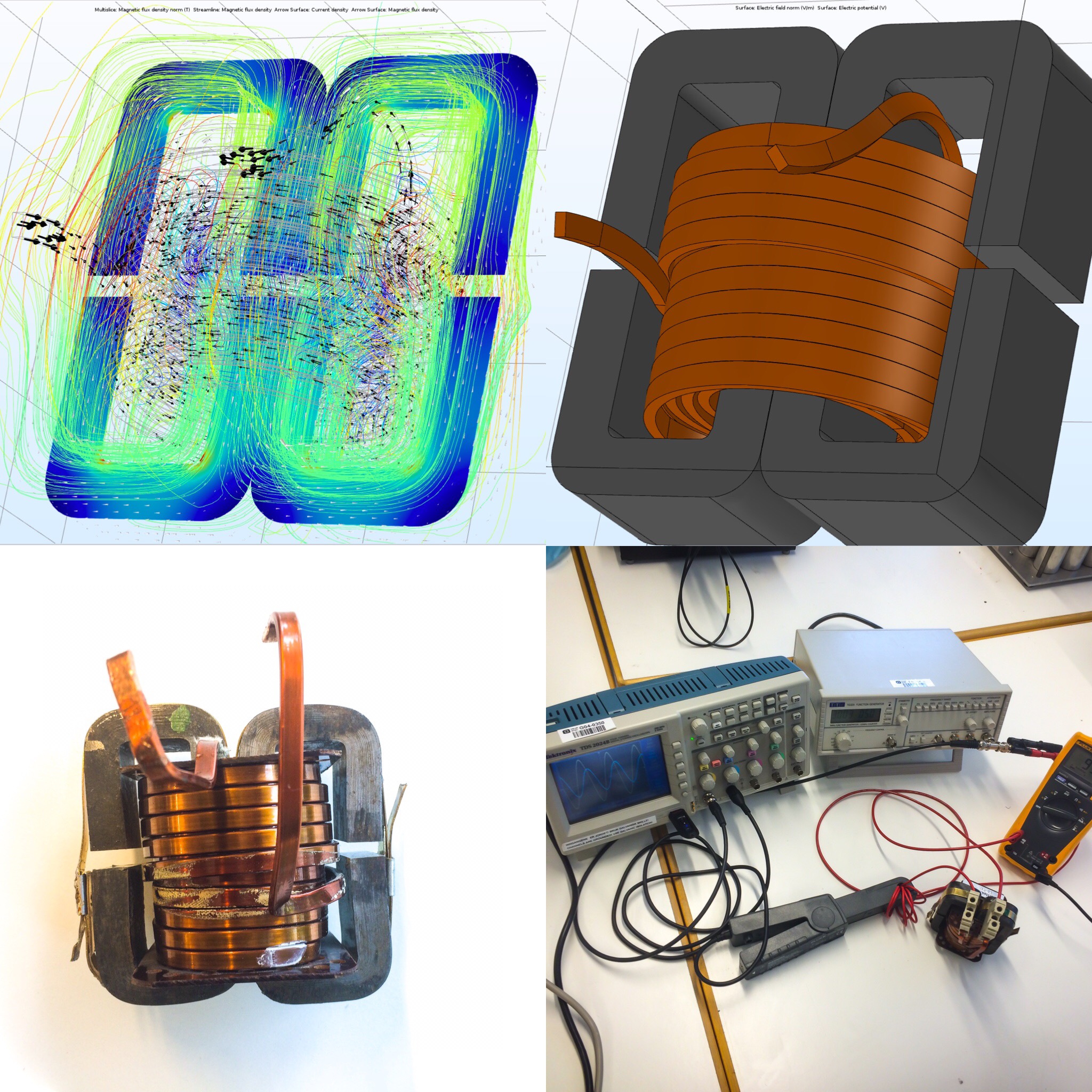

Greetings, Ivar. It is an honor to have you in my thread :)
My fault is almost bordering idiotic, but I forgot to disable the study "coil geometry analysis" after disabling the multiturn coil.
After that it worked out nicely, and I got good results:
Physical inductor: measured by impedance method at 128 uH
Modelled replikaka in comsol: 126.55 uH
I hope it's not pure dumb luck
