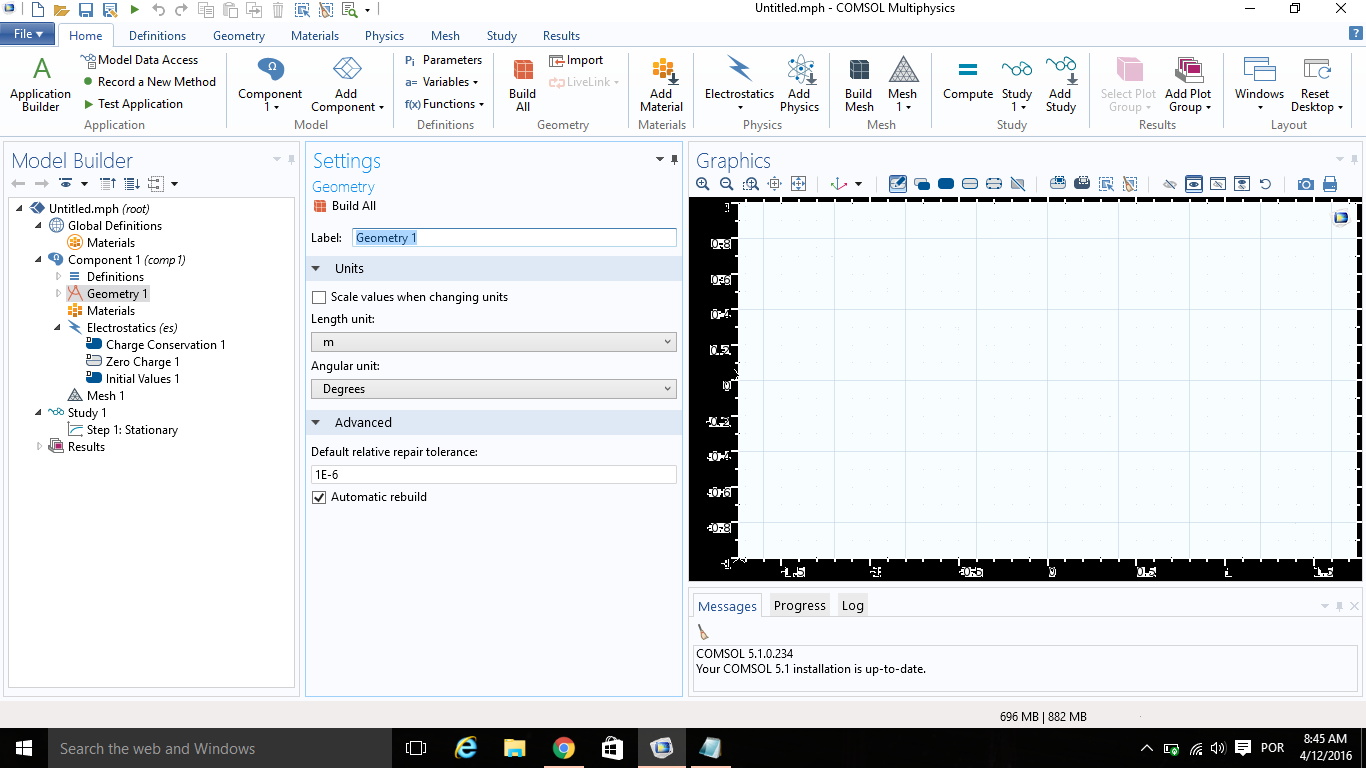

I added a picture here of how my COMSOL is working... or better saying, not working at all.
I'm afraid I need to buy some video enhancements for my computer to be able to use it.
Anyway... is there any possibility to fix it just by changing some configurations ?
Even If I have poor visualization power, I don't care haha.
I just need to be able to use it properly.
Thank you for your help!

Walter Frei COMSOL Employee
Posted: 9 years ago 12 apr 2016, 19:14 CEST
Dear Thales,
To resolve the issue that you're reporting, please see:
www.comsol.com/support/knowledgebase/933/
