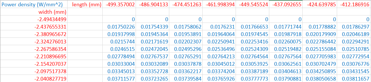

Hello everyone, I have a question about importing data into COMSOL which I would then like to impose on my model. I have an excel spreadsheet that contains Width(x) and Length(y) and then x*y amount of data points for Power Density(z). I'm not quite sure how I can important this amount of data in to COMSOL. Do I need to come up with a function for the power density z and then apply this separately to my model? Any help or hints in the right direction are greatly appreciated; thanks in advance. I should include that I have been trying to use the interpolation function without much success.

The data in your Excel sheet has a structure fairly close to the grid format that interpolation functions can read. I suggest that you consult documentation and do the necessary restructuring of it in Excel.
