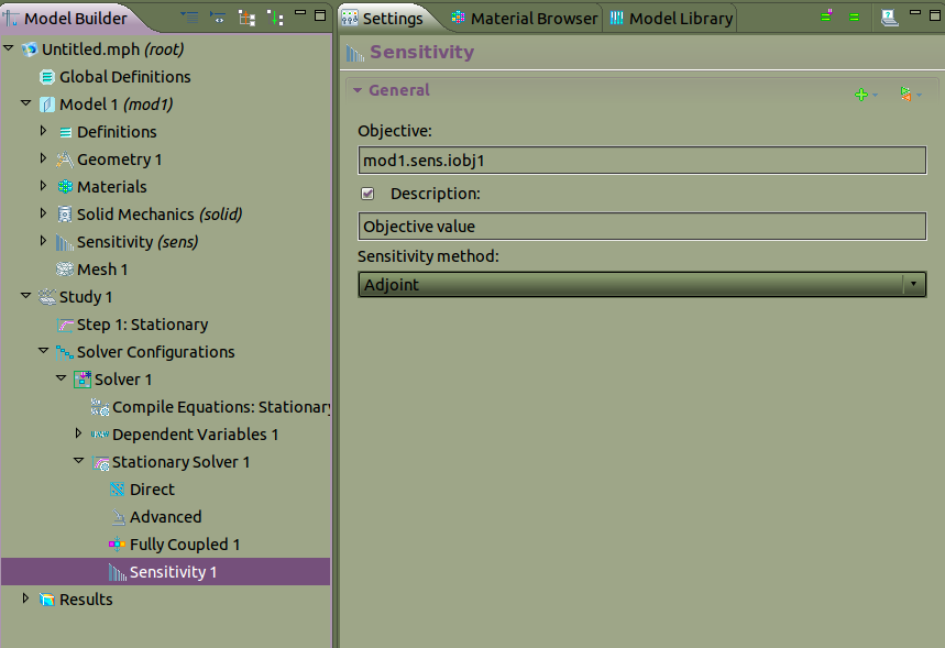

Here is how I could specify the sensitivity method.
In my problem, I use stationary solver. First, I added sensitivity as an additional physics to my model. After specifying objective function and control variables, I computed solution. Once a solution is computed, a relevant tree appears below solver configurations (Study 1 -> Solver Configurations). Down the tree, a right click on stationary solver 1 (Study -> Solver Configurations -> Solver 1 -> Stationary Solver 1) allows me to add sensitivity node to stationary solver 1. In this sensitivity node, the sensitivity method can be set as either forward or adjoint. An image file showing the tree is attached.
I guess, one can similarly set sensitivity method for transient solvers too.
Initially. I too was clueless on specifying sensitivity method. As a last resort, I made a small model in COMSOL 3.5a. Examination of this COMSOL 3.5a model in COMSOL 4.2 gave me the necessary clue.
Here is how I could specify the sensitivity method. In my problem, I use stationary solver. First, I added sensitivity as an additional physics to my model. After specifying objective function and control variables, I computed solution. Once a solution is computed, a relevant tree appears below solver configurations (Study 1 -> Solver Configurations). Down the tree, a right click on stationary solver 1 (Study -> Solver Configurations -> Solver 1 -> Stationary Solver 1) allows me to add sensitivity node to stationary solver 1. In this sensitivity node, the sensitivity method can be set as either forward or adjoint. An image file showing the tree is attached. I guess, one can similarly set sensitivity method for transient solvers too. Initially. I too was clueless on specifying sensitivity method. As a last resort, I made a small model in COMSOL 3.5a. Examination of this COMSOL 3.5a model in COMSOL 4.2 gave me the necessary clue.
