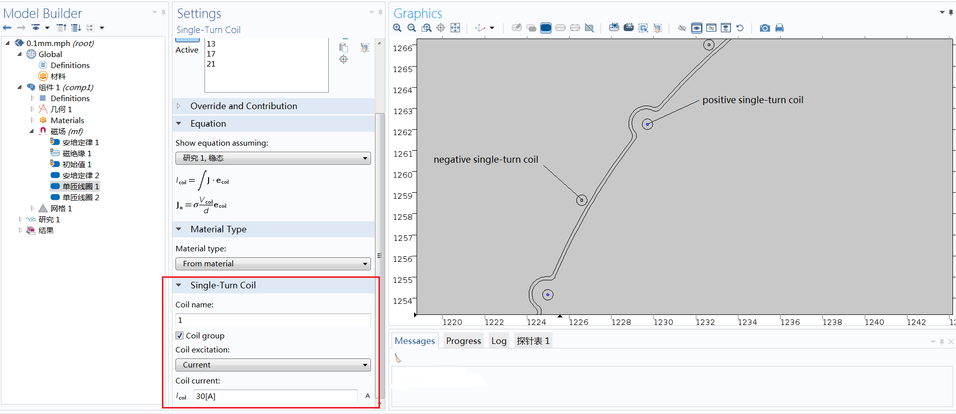

Can i make the coil current in the single-turn coil a negative number??
Hi!
I simulate a 2-D modle.There are two single-turn coils that is series connection. The parameters of the coils are all same except their coil currents are contrary.So i should make a one coil's current is a positive number and other coil's current is a negative number?Or what should i do that can express their coil current is contrary in 2-D modle??
thank you

The single turn feature can have sub node "Reversed Current Direction ". Rght click on the model tree.
Regards
Jens
The single turn feature can have sub node "Reversed Current Direction ". Rght click on the model tree. Regards Jens

thank you!!
I get it!
thank you!! I get it!
