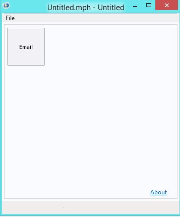

Abdulrahman Al Rumaidh
Posted: 10 years ago 16 gen 2016, 19:03 CET
How do I set up a gmail email in COMSOL preferences. I set the following but it didnt work:
Host: smtp.gmail.com
Port: 587
Security connection: TLS/SS
User: example@gmail.com
Password: ******
From: example@gmail.com
Default to: example@gmail.com
I wrote the following code (I attached a screenshot for my simple application) :
EmailMessage mail = new EmailMessage();
mail.setFrom(emailFromAddress());
mail.setTo(userEmailAddress());
mail.setSubject("COMSOL notification");
mail.setBodyText("Done");
mail.send();
When I run the application builder and run it, it gives me the following error:
Failed to send email.
failed to connect, no password specified?
Why does this error show up although I set the password in the preferences?
