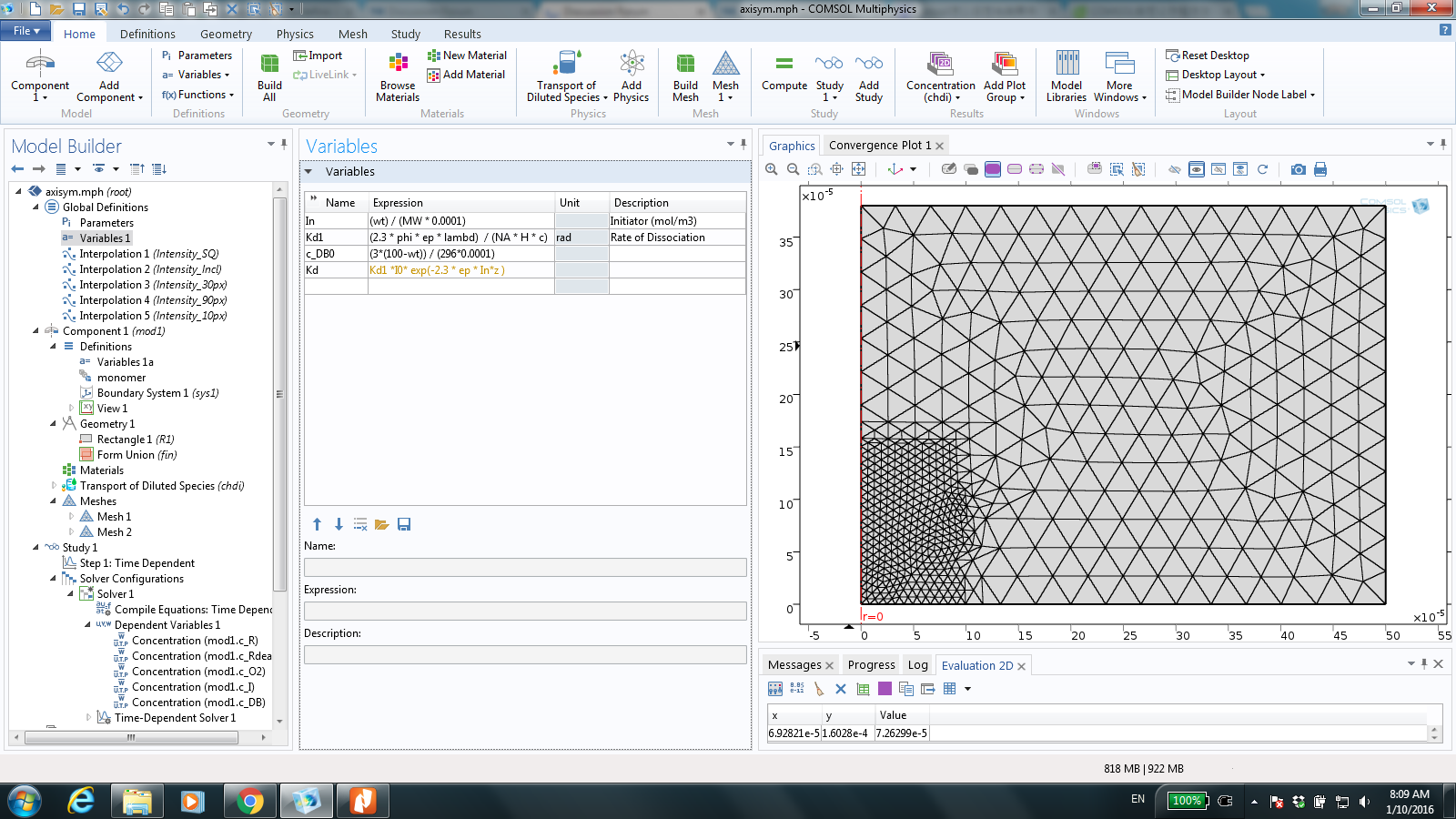

Hi, everyone, I am trying to run COMSOL file in COMSOL 4.4. My file originally works in COMSOL 3.5, but when i run it in COMSOL 4.4, one variable appears to be orange and I cannot get any result. I am trying to simulate a ultraviolet light go through a resin and cure the resin. my defined variable is related to the resin depth which is z axis value in the final result. I used to put z to define the relationship in COMSOL 3.5 and it works. I am wandering how I should define in COMSOL 4.4. I attached some photos to better illustrate the situation.

the updates and changes from v3 to V4 are quite drastic, most internal variables have changed names, so my advise: rebuild your model from scratch in the new version, then start modifying it or adapt it. The power of the new modules makes the model building a rather quick task (once you find your way comfortably through the model nodes ;)
Hi the updates and changes from v3 to V4 are quite drastic, most internal variables have changed names, so my advise: rebuild your model from scratch in the new version, then start modifying it or adapt it. The power of the new modules makes the model building a rather quick task (once you find your way comfortably through the model nodes ;) -- Good luck Ivar
