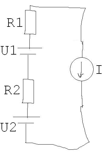

The electrical circuit illustrated in the attached image is a very simple model of a fuel cell stack containing two fuel cells. What I would like to do is to replace R1, R2, U1 and U2 with 2D or 3D structures with R and U being functions of x and y. For R I can easily create solids with their conductance being a function of x and y. However, I can't figure out how to create the distributed voltage sources. Any suggestions?

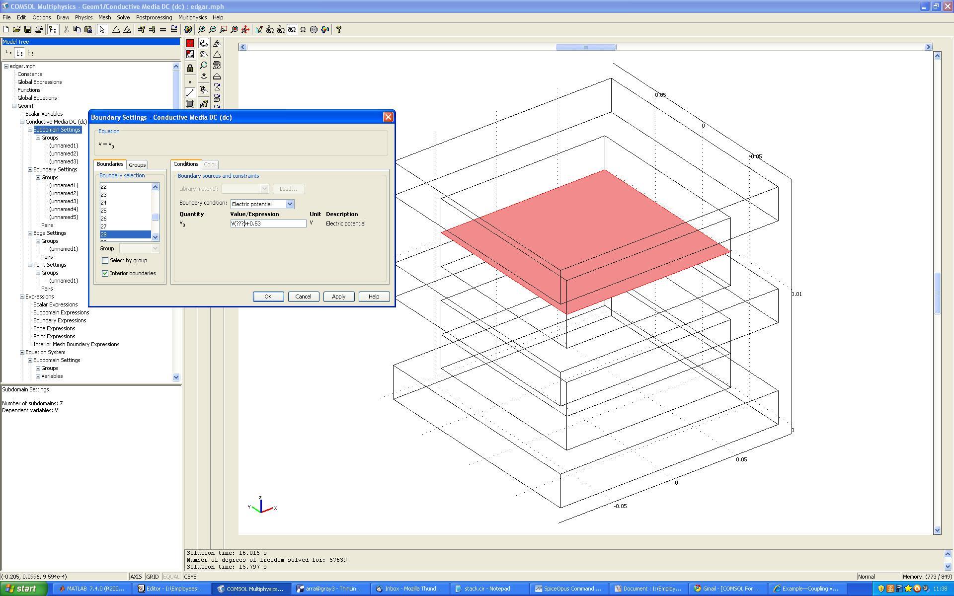

How do I enter the following BC: PlusU2 = V(MinusU2) + deltaU2.
The attached screen dump explains my question. Boundary 28 corresponds to PlusU2 and boundary 25 corresponds to MinusU2. For simplicity deltaU2=0.53.
Anders
your expression would be V(x, y, z)+0.53. For (x, y, z) you use a point on your MinusU2 boundary or in the corresponding electrode subdomain. The variable V is the variable for electric potential in COMSOL 3.5a. You may need to check if it is the same in V4.0.
Let me know if it works
Edgar
I can't get it to work.
The attached mph file (comsol 3.5) models a conducting cube. The bottom boundary is set to V=1 the top boundary is set to V=V(0.5,0.5,0)+3, where (x,y,z) = (0.5,0.5,0) is a point on the bottom boundary. Other boundaries are insulating. The solution gives a voltage of 3 at the top boundary and not 4 as expected.
