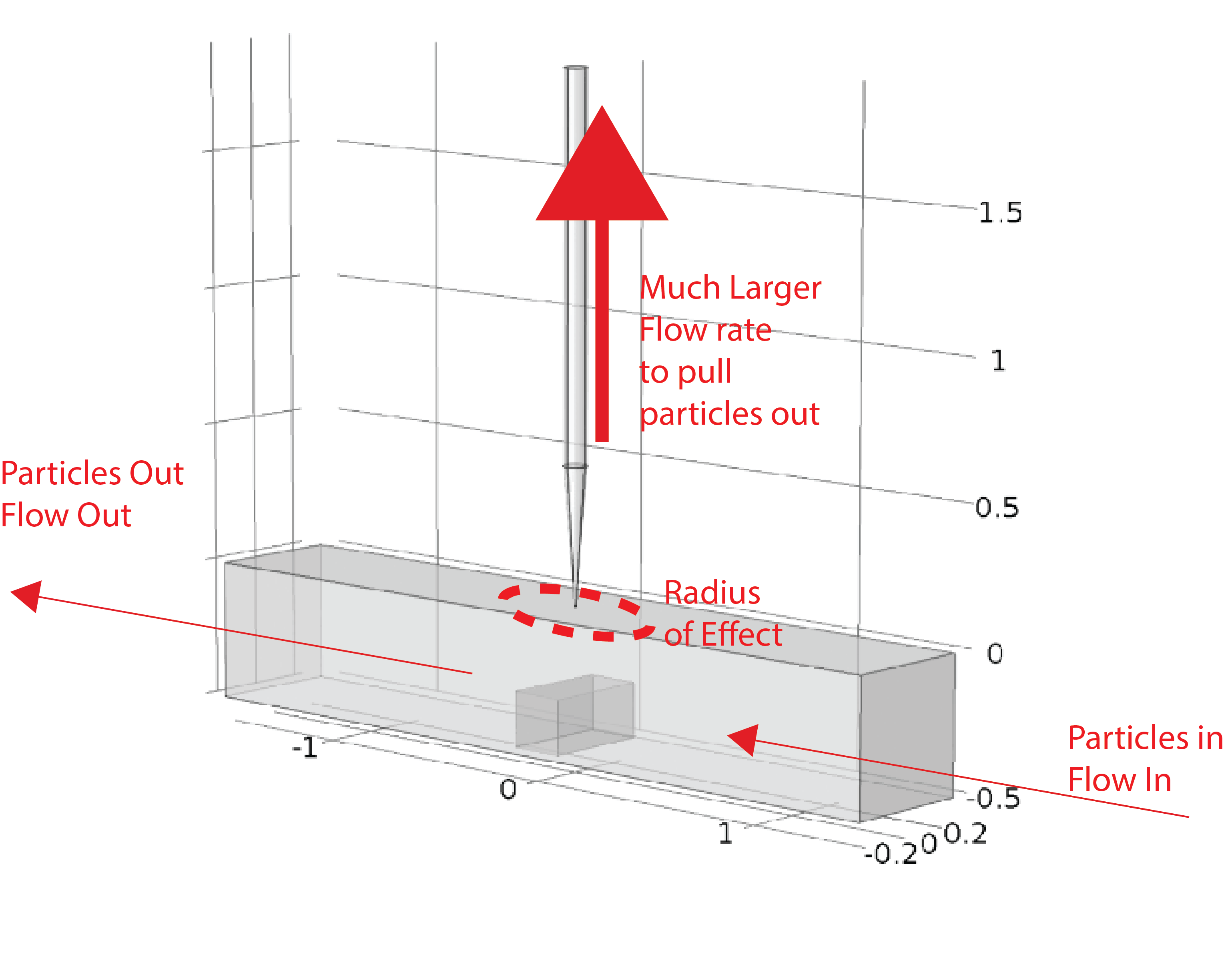

I am trying to model an automated syringe(100um) sampling out 45um particles as they slowly flow through a channel about 1cm in diameter. I would like to know what is the effective area in which I can apply a negative flow rate or pressure to the syringe, a particle flowing past might be pulled up.
[Attached]: Model Diagram
