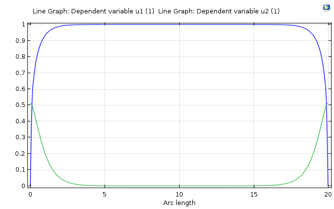

I am using the latest Multiphysics coefficient PDE solver to address the problem of finding lattice solutions of a 2D system in cartesian coordinates.
For this problem the COMSOL solver is really well suited, it allows one to specify periodic boundary conditions which extends the solution of a single unit cell to the whole cartesian domain and it includes the option of imposing pointwise constraints such as boundary conditions at the corners of the cell etc.

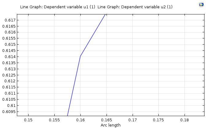

I find converging solutions to the problem which look like the solutions I would expect (see attached sol1), however when I zoom in to these solutions I find that there seems to be a point where the solution is not smooth (see attached sol2). This is worrying since if the solution found is truly non-smooth then it doesn't correspond to a physical solution, if instead it is just a numerical artifact then I can safely proceed with it.
My question is therefore, how can I make sure I can safely interpret the solution to be smooth? Or on the contrary, how can I know for sure the solution is not everywhere smooth?

Gianni,
Seems this is mesh-related effect. Try to refine the mesh and observe change in curve smoothness.
Sergei
Gianni, Seems this is mesh-related effect. Try to refine the mesh and observe change in curve smoothness. Regards, Sergei
