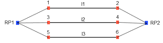

In the attached file you will find a figure illustrating what i exactly want to do :
The whole problem is defined by 3 subdomains on which there are 3 differents subdomain-settings. The point is that i would like to introduce coupling between points 1,3,5 and coupling between 2,4,6. So i wonder if i can define 2 reference points RP1 and RP2 and define a "link" between 1,3,5 and RP1 and an other "link" between 2,4,6 and RP2.
Maybe it is posible to define coupling equations between the different boundaries, but i don't know how to do it.
Tanks !
In the attached file you will find a figure illustrating what i exactly want to do : The whole problem is defined by 3 subdomains on which there are 3 differents subdomain-settings. The point is that i would like to introduce coupling between points 1,3,5 and coupling between 2,4,6. So i wonder if i can define 2 reference points RP1 and RP2 and define a "link" between 1,3,5 and RP1 and an other "link" between 2,4,6 and RP2. Maybe it is posible to define coupling equations between the different boundaries, but i don't know how to do it. Tanks !

you have to better define what you mean by "link", in principle this is possible for most cases, via coupling variables, predefined BC's or weak constraints all depends what kind of physics you have (and via the weak constraints you have mono and bidirectional links)
Hi you have to better define what you mean by "link", in principle this is possible for most cases, via coupling variables, predefined BC's or weak constraints all depends what kind of physics you have (and via the weak constraints you have mono and bidirectional links) -- Good luck Ivar

Let's imagine that my problem is made of 2 variables u and v. On boundaries 1,3,5 i want to set u(1)=v(1)= u(3)=v(3)= u(5)=v(5)=0.
Then on boundaries 2,4,6 i want to set u(2)=u(4)=(6)=C ; where C is a constant that I impose.
So there is no difficulty for this.
And I want v(2)=v(4)=v(6) but I don't now how to impose this equality.
Do I have to define a coupling variable w, so that I will set v(2)=v(4)=v(6)=w (where w is free) ?
Let's imagine that my problem is made of 2 variables u and v. On boundaries 1,3,5 i want to set u(1)=v(1)= u(3)=v(3)= u(5)=v(5)=0. Then on boundaries 2,4,6 i want to set u(2)=u(4)=(6)=C ; where C is a constant that I impose. So there is no difficulty for this. And I want v(2)=v(4)=v(6) but I don't now how to impose this equality. Do I have to define a coupling variable w, so that I will set v(2)=v(4)=v(6)=w (where w is free) ? Thanks

Your problem is not a "well posed pde problem but look like a "control problem" that comsol cannot solve directly [ they are harder to solve too] .
beware, too, it is also possible that your problem is not well posed and dont have a proper solution but without knowng anyting of it i will assume it is well posed.
Tere is a ton of bibliography on how to solve these "control" problems for they are very important in practice. [ for example your boundary condition could express the fact that you want equal temperature on several faces of an object to control differential stress but that you dont really care about the value of its temperature...
Usually the way you solve them is by finding a functionnal that will be for example minimum when your "control" boundary condition v(2)=v(4)=v(6) is met
the test function are the set of then NON UNIQUE solution of your PDE with your other standard BC.
You can also for some problem find an iterative problem where each step is made of one set of classical pde with its "normal BC" that converge toward the solution of your problem.... it really depends on the specific of your problem here.
I am not sure if Comsol can resolve this problem alone but it is possible that with matlab it can provide some input, at least IF your PDE are linear [ because then you can use a few exact solution to describe the full set of solutions...
Not sure if I am clear but in short my advice will be
1 make sure your problem has really a solution
2 look at bigraphy on control which is very large
and
3 from there make your choice.but again comsol is designed to resolve "straight pde problem" you will have to do more to resolve your problem.

I've managed to do what i want, using integration coupling variables,
Thanks for your time !
