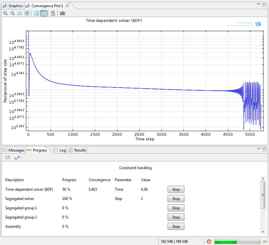

Just want to know, what does that curvy distorted line at the end of the diagram shows?
Does it mean I have instability convergence? too large time step?
how do I solve this? I am getting singularity error everytime.

I solved the error already,
I did it by reducing the time step in my "Study: Time-dependent" for example by making range (0,0.5,1) to range (0,0.1,1).
And I also followed the "improving convergence in nonlinear time dependent model" on the COMSOL discussion. (www.comsol.com/support/knowledgebase/1127/)
Do you know what it means by convergence? What does it value shows actually from the image that I have attached? What does it mean if the convergence decreases or increases as time goes on?
