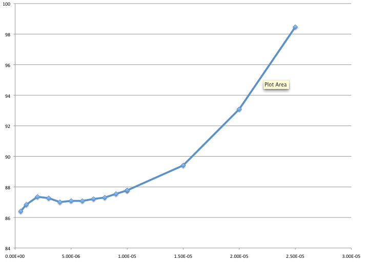

A number like Nusselt number is a combination of several parameters.
Let's say (incorrect but simply) that
Nu_local = Flux / (T-T_bulk)        ---------------- at each node
and
Nu_average = Int (Nu_local)/Int (1)           -------------  defined on the cylinder boundary
Then both flux calculation and T values at the boundary becomes important.
Then when I do a mesh study on the cylinder perimeter I get figure 1. As you notice as the mesh size (x axis) decreases I get a better Nusselt number, but then it starts going down like crazy. That mesh size is already too small, which makes the model impractical. So, the question is this: Is the mesh good enough at the middle range?
There maybe many factors that affect this behavior:
1) Artificial diffusion. I heard from support as the mesh size reduces, the error introduced should get lower. But who knows how it works under the hoods.
2) Comsol's calculation of boundary values between two adjacent domains. As the mesh gets smaller T1 (of domain cylinder) gets closer to T2 (of domain fluid).
3) Calculation of Integrals. Since reacf is a summation integral and I still have T which is not. does Int(reacf(T)/(T-Tbulk)) work as expected? It was much more stable with Comsol's total flux functions. Less accurate but stable.
Already too long to read, so I stop here.
I'm all ears.

                                                    I was talking to a PostDoc yesterday and he told me that if there is such a "S" shape behavior of your mesh study curve there should be something wrong with the model. I am not sure what to say so far, as I am not sure about when Artificial Diffusion kicks in, or other underlying comsol, since my model is simple enough.
Any ideas?
