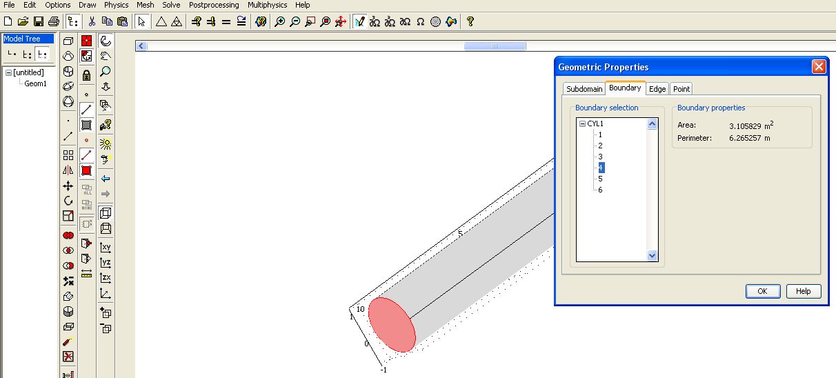

1. if we draw a cylinder with unit radius(R=1) and if we want to see the face area it should be (Pi*R^2)
i.e (Pi*1^2) = value of Pi = ~3.1415926535897932384626433832795
but in comsol it shows ~3.105829 why??? so much error and how to minimize it???

"Oh i forgot one more thing
but in comsol it shows ~3.105829 why??? so much error and how to minimize it???"
Your mesh may be too coarse. Try refining, update model and recalculate are- it should converge to true value of pi.
"Oh i forgot one more thing 1. if we draw a cylinder with unit radius(R=1) and if we want to see the face area it should be (Pi*R^2) i.e (Pi*1^2) = value of Pi = ~3.1415926535897932384626433832795 but in comsol it shows ~3.105829 why??? so much error and how to minimize it???" Your mesh may be too coarse. Try refining, update model and recalculate are- it should converge to true value of pi.
Posted: 2 decades ago 23 set 2010, 15:57 GMT-4
Hello Ozgur Yildirim,
I have not mesh the geometry. I have just generated a cylinder of Radius 1 meter and height 10 meters. If you have comsol plz try in. to see the geometrical property of the cylinder i went to Comsol>Draw> Geometrical Properties> Boundries.
And if you can address my above problem as well.. it could be a great help.
vishnu
