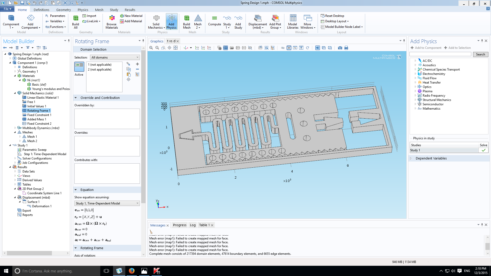

I do have problem in simulation of design made in COMSOL 4.4.
I have attached the figures but I do not understand where do I lag.
I have used Structural Mechanics, Figure 1
-Rotating Frame
-Time Dependent model in study

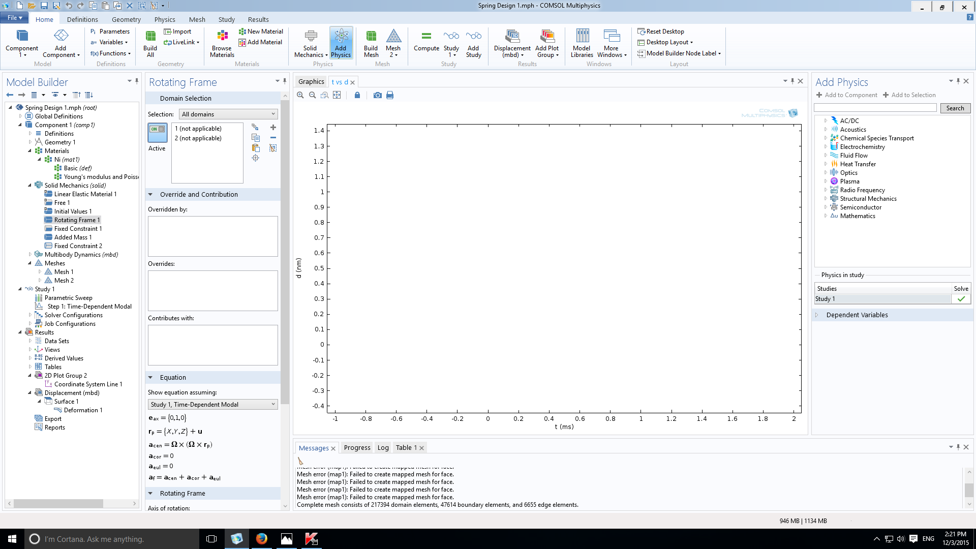

I was suppose to get the plot for time (ms) vs Displacement (mm) but I got just the axis and not the plot. Figure 2.
The design is such that, the complete system is rotating at 400rpm clockwise (or may be anticlockwise.. no issues) and is moving vertically too with approx. 1035m/s at 15g (g is gravitation (m/s^2)). So there will be counter reacting forces due to radial and vertical movement. The microspring system designed is to get latched within 100ms.
Also I do not get any latching or simulation in design. Please help. The screenshot contains the open carrots.
