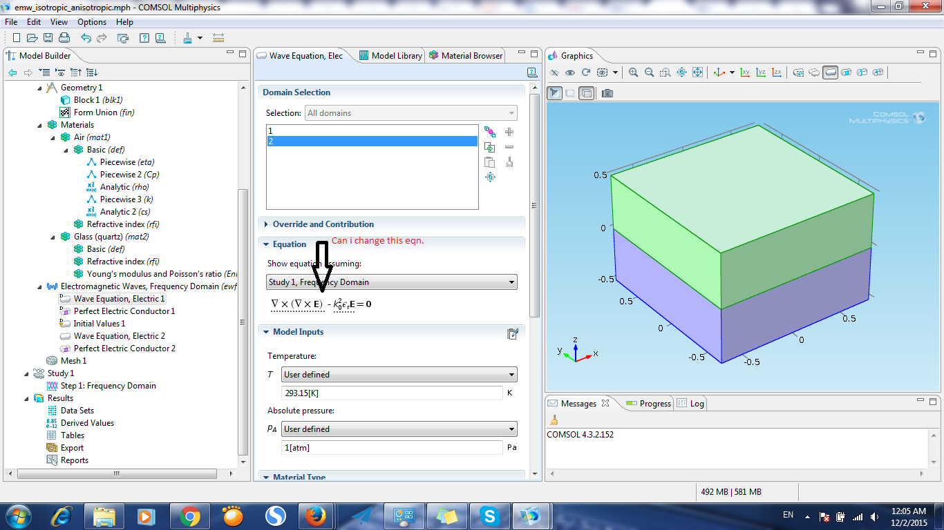

Thanks Jeff for replying me. Actually I need to simulate a magneto-electric media in light of my own general theory. I am afraid if I can do some slight changes in the preamble of the software. Please see the attached file. I need your comments on this. Besides, I have read that paper that you have mentioned, yet I feel some problems. Please see the attached file.

Hello Mahmood,
Yes, should you need to do that, it is possible in COMSOL to modify the pre-implemented equations the software solves, and/or you can also set your own equations from scratch if you prefer. You will find this capability extensively presented in the documentation (Look for "weak form" and "equation-based modeling" in particular), and feel free to contact COMSOL support if you need a bit more help and have a license that is eligible for this service.
Hello Mahmood, Yes, should you need to do that, it is possible in COMSOL to modify the pre-implemented equations the software solves, and/or you can also set your own equations from scratch if you prefer. You will find this capability extensively presented in the documentation (Look for "weak form" and "equation-based modeling" in particular), and feel free to contact COMSOL support if you need a bit more help and have a license that is eligible for this service. Best regards, Jeff
