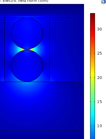

I have recently simulated graphene-based plasmonic waveguide at 10 THz. The thickness of graphene is set to be 0.7nm. I use relative permittivity to represents the graphene. Now, when the single graphene is neglected or considered in my modal, the Effective mode index does not change, the fied distribution does not change, only the change of the electric field amplitude. I wonder the thickness of graphene is too thin to influence optical field. Whatever graphene is considered or not considered, the field is only suuported by dielectric waveguide mode.

The field does not interact with graphene if the electric field is normal to the graphene sheet. You need to have a strong in-plane component of electric field to have the interaction.
And it is better to model graphene as a 2D current density in the boundary conditions.

Thank you so much for your reply. I have already modeled graphene as a surface current density. Indeed, the electric field does not interact with graphene when the incident elecric filed is normal to the graphene.The reason is the fact between TM mode and TE mode.
