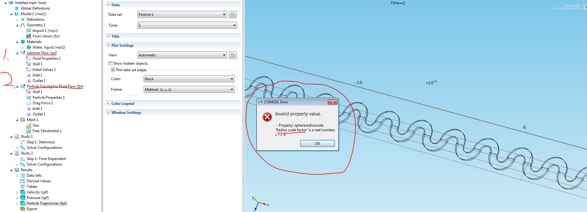

I have a problem when I run a simulation about particle tracing. Its about the particles in the laminar flow. I can compute the first step , laminar flow, with no problem. however after adding another physics, particle tracing, i cant compute and always receive a error message.
The error message is,
Invalid property value
-property: sphereradiusscale
"radius scale factor" is a real number.x>=0
because i can compute the first step, i think its not for the reason of the geometry. Does anybody have idea to solve this problem?
THe attachment is the pic of the problem.
