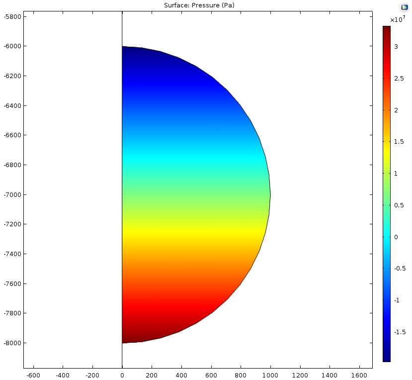

Regarding 1), the initial stress is to reproduce the initial lithostatic crustal stress. It has been validated in several solid mechanics-only models. It should be equivalent to your solution of preloading it by first running the stationnay solution (I will check that).
I am still not understanding how the volume force works.. On the figure attached, you can see the fluid pressure when just subjected to the applied volume force of - rho * g , not any other force, and just solving for the fluid part. I am not understanding the sign and magnitude of it, which are not equivalent to -rho*g*z.
Thanks,
Helene

Volume force is the force applied to "dx*dy*dz[m^3]" hence it's "spf.rho*g_const[N/m^3]". Formally its the product of both that gives you the force, and total force once integrated over the full domain(s).
Now gravity is mostly defined along "-z" hence the traditional minus sign for Volume Forces, to add to the formula above.
Now, for the initial condition it is different.
This depends where you set the gauge pressure p=0[Pa] level. So if your fluid is just above z>=0 then the initial condition (again applied to the element volume "dx*dy*dz") is "-spf.rho*g_const*z".
The means that the pressure would be p(z=0)=0[Pa] and it will be relative with a negative sign above z=0.
If you try to solve fluids alone and set the initial condition correctly your model might not converge fully, but still it should give a correct pressure value.
Then for the initial stress tensor, the diagonal elements should not be all equal from my understanding, the two first OK are isotropic in R & Phi, but the Z component should be greater. Here again one need to define the "zero gauge Z level", so if gravity is along -Z the diagonal elements should be from my understanding: "-g_const*solid.rho*( nu/(1-nu) , nu/(1-nu) , 1)*z" all in [Pa]. with Z=0 at top level of the solid.
