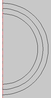

Thank you sir,
I have 2 layers one above the other (2 concentric layers on a sphere) having different materials, both layers have different diffusion coefficients (D1, D2). 1st layers is made up of 'c1' and 2nd layer is made up of 'c2'.
The material of my interest is 'c1'.
'c1' has to diffuse through the 2 layers. In the second layer it has to diffuse through 'c2'.
How can I model this system?
If I am using 2 Transport of diluted species physics separately for these 2 layers, what should be my boundary at the interface of these 2 layers?
I am modeling in 2D axisymmetric
Thank you sir,

You do not need two physics nodes, just define different diffusion coefficients in the two layers, as well as initial concentrations. If possible, please submit your model.
