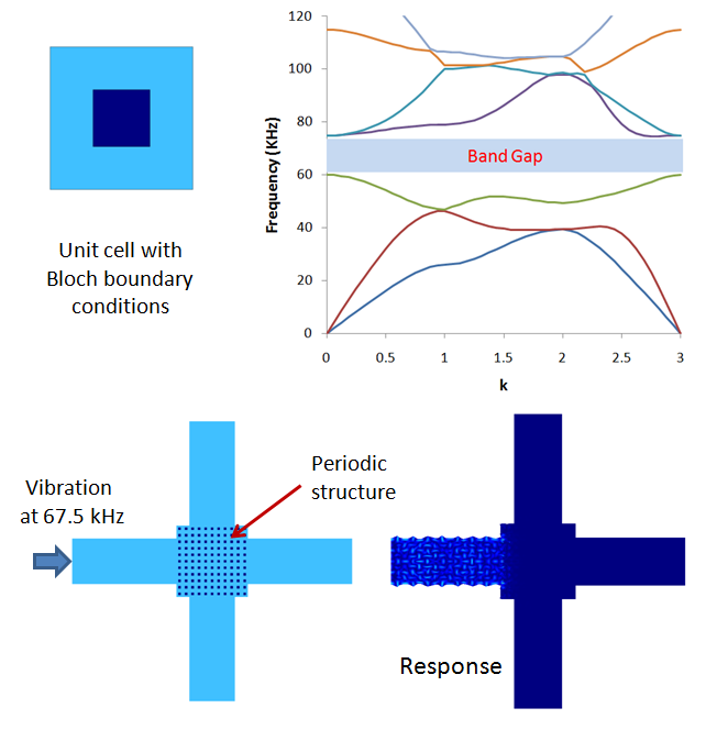

[QUOTE] I used COMSOL a while back for a similar problem involving the band gap of a phononic crystal (see attachment). At that time I had to implement the Floquet/Bloch boundary condition manually. Now it is available as a boundary condition for structures but I have not yet tried it. You define it by creating a Periodic Condition and in Type of Periodicity select Floquet periodicity. Nagi Elabbasi Veryst Engineering [/QUOTE] Thank you guys both. Yeap, that was my bad, I should have written 4.2 instead of 4.3. It seems that it is fixed in 4.3 but you cannot apply Floquet boundary in 4.2. Nagi: did you draw the eigenfunctions in your band diagram with Acoustic module? Ruben; Good that you are still working on this. Seems that you have been working on this subject for a while. Anyways, I don't have the 3.5 to check the .mph and .m files you and Sean have uploaded in 2009 but it seems you already solved this with MATLAB livelink. I just have started to work on this and wonder if it is possible to draw the band structure with Acoustic or PDE interface or it needs MATLAB livelink. I would welcome any comments. Alireza
Posted: 1 decade ago 17 ott 2012, 00:07 GMT-4
Thanks Alireza,
Actually that is an Excel generated plot. I had a very similar one generated within COMSOL (no modules were required I believe).
Thanks Alireza, Actually that is an Excel generated plot. I had a very similar one generated within COMSOL (no modules were required I believe).

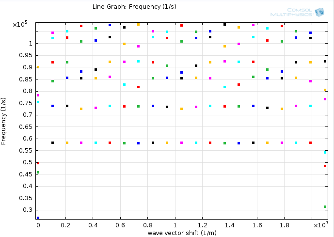

Posted: 1 decade ago 10 giu 2013, 18:26 GMT-4
Hi Alireza,
May I know how actually do you manage to plot a bandgap. I have been trying to do using the bandgap_photonic_crystal_sbs example but to no avail. Basically I am trying to model a 2D structure as shown in the attached photo.
What I've done so far is making sure that the mesh at the boundaries are the same by copying one edge of the rectangle to the rest of the boundaries. I then set the kx and ky in the floquet boundary condition using the example in the bandgap_photonic_crystal_sbs.
I then used the parametric sweep in the study computation. When i plot k against the eigenfrequency, I always get the same plot no matter what I did to the dimension of the rod. Should I use 1 or 2 boundary conditions?
I would appreciate if you or anybody else can help. Thanks.

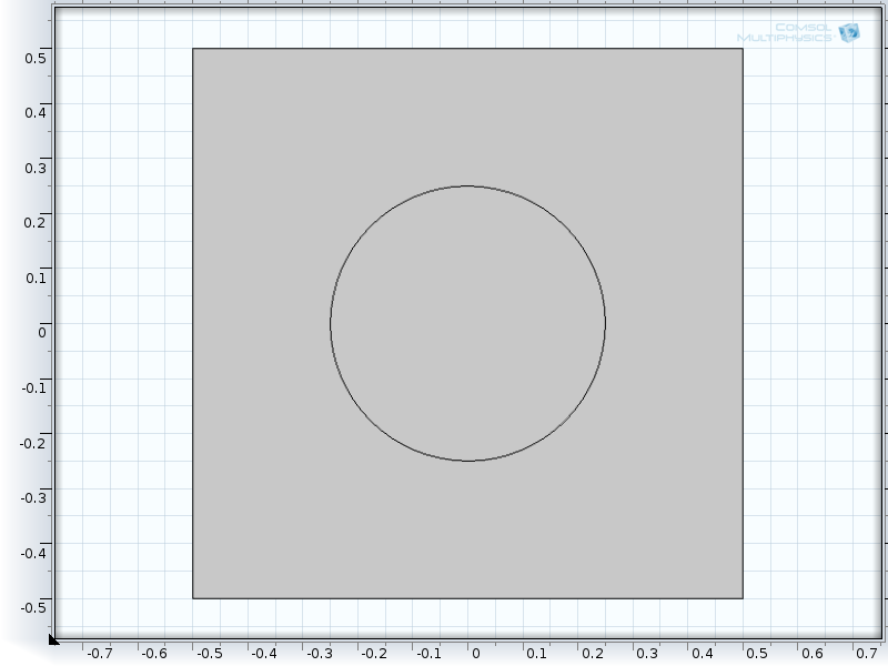

Hi Nagi,
I am trying to get a band structure for a simple 2d sq lattice (solid circle in a solid matrix); but I did not get the z-mode (longitudinal mode), just the transverse mode only , what i did was: (I am using comsol 4.4)
1. used acoustic-structure interaction, elastic wave (elw) module
2. chose both domain linear elastic material.
3. Floquet periodicity (1,4) and (2,3) boundaries.
4. took the parametric sweep for kx = 0 to pi/a
5. finally got kx vs freq (derived values > global evaluation),
but this kx vs freq gave me just transverse modes only, longitudinal mode missing. I am lost. Please suggest me how to get longitudinal modes. Any help would be greatly appreciated.
Also I am having problem with liquid matrix with solid scatterer.
Thank You very much,
Ukesh

I uploaded a COMSOL file to the Model Exchange that shows how to set up a phononic band gap eigenfrequency analysis. Here is the link: www.comsol.com/community/exchange/432/.
Nagi Elabbasi
Veryst Engineering
I uploaded a COMSOL file to the Model Exchange that shows how to set up a phononic band gap eigenfrequency analysis. Here is the link: http://www.comsol.com/community/exchange/432/. Nagi Elabbasi Veryst Engineering

Hi Sean and all,
I am currently doing band structure analysis on periodic structures, but I am pretty new in this area, and I do not have very solid background on solid physics. Could you guys please recommend me some textbook or material to read on the procedure of constructing the band diagram?
Personally I have no idea how the eigenvalue problem of field equation is solved and how do we relate the wave vector k to the Irreducible Brillouin Zone ( which will be stretched as the x axis in band diagram, if I am understanding correctly).
Thank you!!
Nagi Elabbasi
Veryst Engineering
