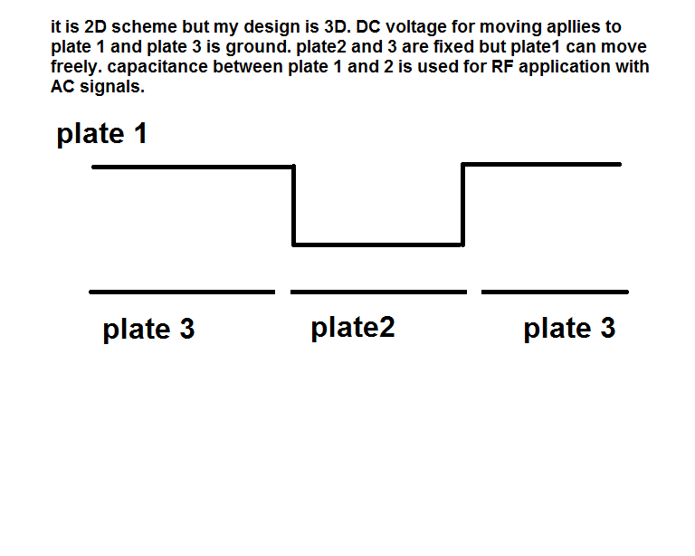

Posted: 1 decade ago 22 dic 2010, 07:35 GMT-5
thanks Ivar
one of the big problem that i face to it, is Residual stress, in Comsol documentation i red an example about that but it wasn't very useful for me
when i simulate a simple fixed-fixed beam in comsol spring constant of beam is much lower than theoretic solve, ant that different results is due to residual stress. i don't know how to apply residuall stress to a simple beam or plates of a variable capacitor?
another question is about calculation of capacitance.
i have attached a image of my design but in 2D view. but my design in comsol is 3D. i want calculate capacitance between plate 1 and 2 while i applied different voltage between plate 1 and 3. in fact difference voltage between plates 1 and 3 causes plate 1 move to down and change capacitance between plates 1 and 2. it is great problem for me to simulate capacitance between 1 and 2.
thanks a million
thanks Ivar one of the big problem that i face to it, is Residual stress, in Comsol documentation i red an example about that but it wasn't very useful for me when i simulate a simple fixed-fixed beam in comsol spring constant of beam is much lower than theoretic solve, ant that different results is due to residual stress. i don't know how to apply residuall stress to a simple beam or plates of a variable capacitor? another question is about calculation of capacitance. i have attached a image of my design but in 2D view. but my design in comsol is 3D. i want calculate capacitance between plate 1 and 2 while i applied different voltage between plate 1 and 3. in fact difference voltage between plates 1 and 3 causes plate 1 move to down and change capacitance between plates 1 and 2. it is great problem for me to simulate capacitance between 1 and 2. thanks a million
Posted: 1 decade ago 22 dic 2010, 08:52 GMT-5
If I read you correctly you are in MEMS analysis and your MEMS manufacturing process is inducing permanent stress in the layers so that the overall stiffness of you system is dfferent from an unstressed model. This is rather common, I must say, and the only way around I know about is to build your model layer by layer as you do the techno-processes (and you need partial saamples to validate the reslts for each steps) and then at the end you can run your simualtion on the correctly stressed model with the desied voltage and hopefully the desired stiffness / deformations.
For the capacitance, this is rather a geometrical driven value (except for fringe effects which are not necesarily small) so if you have the correct deformations then COMSOL should calculate the "C" value correctly (including fringe effects if you are in 3D with a sufficiently large volume of "air" around. The 3D model is though very costly so sometimes estimating fringe effects from a 2D model and extrapolating to 3D is about as good, if possible.
