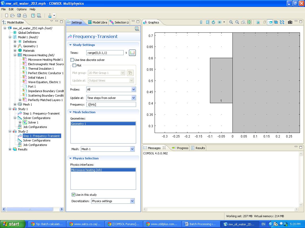

Hi Charles,
Do you have any idea of running batch process on windows?
I have two files and I want to run them one by one in the way that results of one should be used as initial conditions for the other, is there any way of doing it?
Thanks in advance for any of your help!

I have defined the second study step in the same file but could not find any option in the second study to set the results of first study as initial values.(Please see the attached image for the options)
Do you mean that I need to define the whole model again?
Can you please elaborate what do you mean by setting the second file as second study step?
Thanks in advance!
