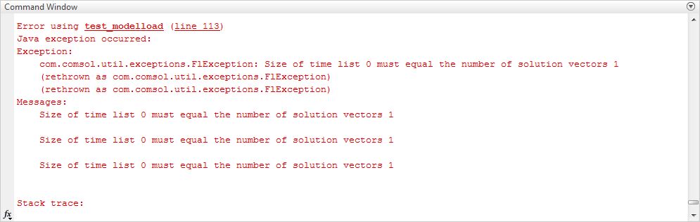

I am using COMSOL 5.1 and COMSOL 5.1 with MATLAB. I have built a COMSOL model and saved it as a .m file (Please see attachment: "test_modelload.m" ). The model has " Transient Study ". Then I opened COMSOL with Matlab and tried to overwrite the solution of the model inside the "test_modelload.m" by writting the command given below:
b = mphgetu(model);
%Redefining the solution vector
b(1)=1;
b(2)=1;
b(3)=1;
%Overwriting the previous solution vector and creatign a new data set
model.sol('sol1').setU(b)
model.sol('sol1').createSolution()
model.result('pg1').run
but COMSOL with Matlab shows error (Please see attachment: "error_matlab.JPEG").
On the other hand, I tried the same command to update the solution in case of "Stationary Study" then it works.
Can anybody please help me how to update the solution in case of a "Time Dependent Study" ? Thanks in advance.
