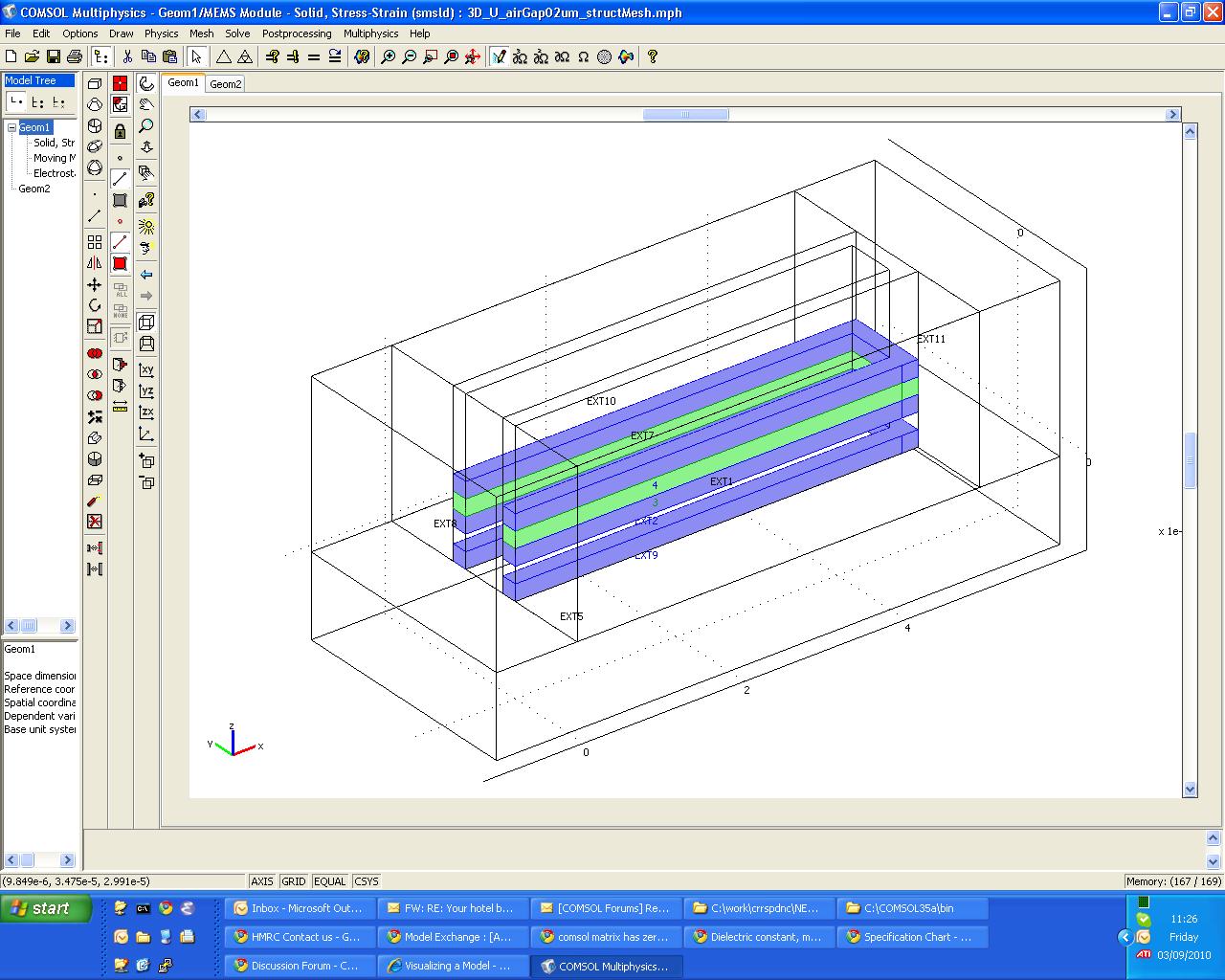

Here's what I tried. I draw my 3-D structure by first defining a 2-D workplane (call it G2) and then extruding it to 3-D (call it G1). I have attached a screen shot of G1. The big block at the bottom is a substrate, the block above it is air. The coloured U-shaped blocks are various materials, the uncoloured U-block is air. The various sub domains are a misguided attempt to manually divide it into rectangular blocks (cuboids).
Now I tried to extrude the mesh, along with the structure geometry, but I can't figure out how to do it. I basically have to extrude multiple shapes corresponding to the U section, substrate and air that I draw in G2. When I create a rectangular mesh in G2 and extrude it, it creates multiple work planes, with each mesh being in a different work plane. I can't seem to reconcile the workplanes.
Alternately, say I create the bottom U section in G2, define a mesh and extrude the mesh to G1. If I change to draw mode, I see that the geometry boundaries match the mesh. Then, if I try to copy the structure by using the array command, the geometry copies, but not the mesh.
How can I extrude, or sweep or copy the mesh in this kind of exercise?
Even if I have the mesh for all 4 U sections, how do I then generate a mesh for the substrate (which has the bottom plate of the bottom U section on its top boundary) and air (which contains all the U sections) using any of these techniques?
Many thanks, Dinesh

In that screen shot, if I try to generate a swept mesh in the substrate by sweeping from the front face to the back, or one side to the other, I get an "invalid topology" error. I can only guess this is because the top surface (which is not the source or destination in the sweep) has a boundary with the U section above it. But you say this should not be a problem?
And one more question please on the other part of your earlier response: "its not so limited (and its better in V4) ;) 3D mesh "sweep mesh" has a limit on the topology: no new surfaces along the seep direction, and on the number of faces at the arrival (only one (if its not the opposite, anyhow the selector does not allow you to choose more than one where it's appropriate) the destination face must have the same topology as the external source face." In that screen shot, if I try to generate a swept mesh in the substrate by sweeping from the front face to the back, or one side to the other, I get an "invalid topology" error. I can only guess this is because the top surface (which is not the source or destination in the sweep) has a boundary with the U section above it. But you say this should not be a problem?

Thanks, but neither of the techniques you mention work for me in 3.5a. Firstly, I cannot sweep the geometry in 3-D normal to the source, even with a single target boundary. If the other defining boundaries are not rectangular surfaces, I get a message saying invalid topology. Its very restrictive.
Secondly, for the reasons I mentioned in my previous post (the second one chronologically), I cannot extrude my mesh either. Essentially, this is because I have to extrude multiple times from 2-D to 3-D to create my full structure. When I extrude a mesh multiple times, I get separate meshes in separate workplanes, not the full consolidated mesh I want.
What am I doing wrong?
