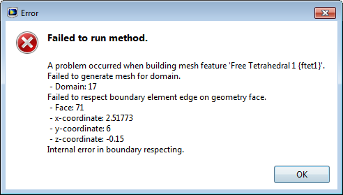

I am working on creating a routine in java, which will attempt to create a mesh for each instance of a parameter defined within a sweep before the solution is computed. Last thing we want to experience is a crash of some job only due to something we could have checked earlier, don't we?
I know this can be done in java using try-catch statements, but in contrary to MATLAB, java would like to know what sort of exception it is supposed to react to:
try
doMesh();
catch(ExceptionType err)
trySomethingDifferent();
Could you tell me what exception I should expect?
I am sending an attachment that shows a typical message after builing mesh has failed.
Thank you very much for your help!

Alright, for now I have specified "ExceptionType" as just an "Exception". The code compiles and the situation is fine, as long as I don't need to refer to any specifics of the error...
[QUOTE] try { doMesh(); } catch(ExceptionType err) { trySomethingDifferent(); } [/QUOTE] Alright, for now I have specified "ExceptionType" as just an "Exception". The code compiles and the situation is fine, as long as I don't need to refer to any specifics of the error...
