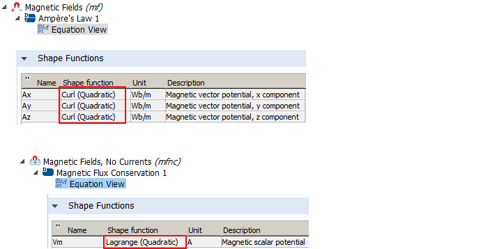

Francesco,
This is because mfnc interface uses Lagrangian elements for magnetic scalar potential and second order derivatives are available for Lagrangian elements.
You can see it under equation view, as shown in the attached image.
Sergei
Francesco, This is because mfnc interface uses Lagrangian elements for magnetic scalar potential and second order derivatives are available for Lagrangian elements. You can see it under equation view, as shown in the attached image. Regards, Sergei

Francesco,
Sergei
Clear now, thank you.
